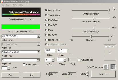

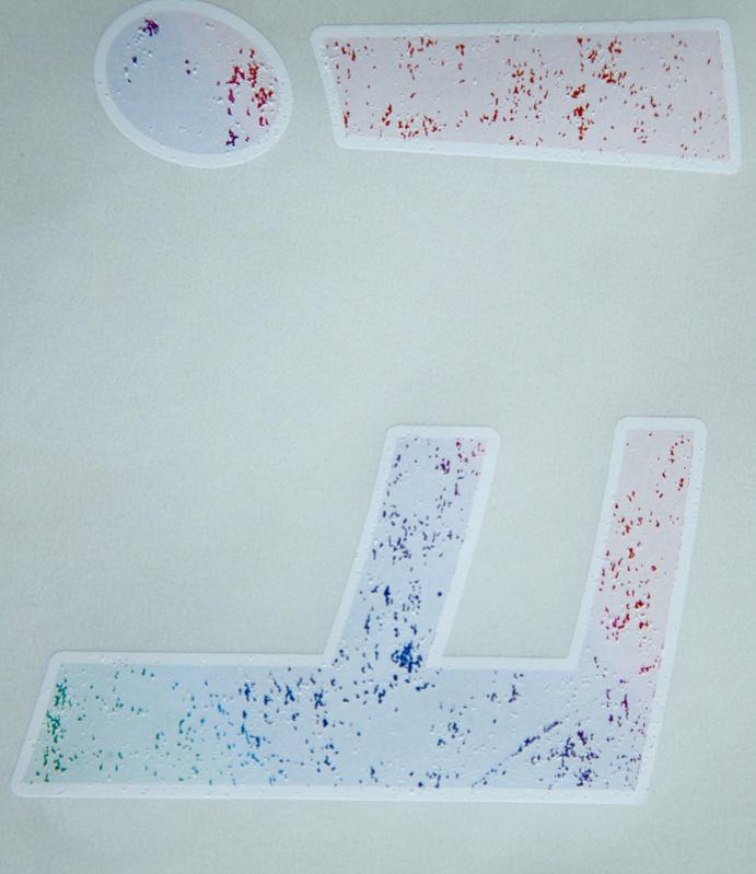

I hope someone can put me straight with this as I'm at my wits end today. I hate to throw money down the drain but that is all I've done this afternoon, I keep getting failure after failure with WoW 7.7 which has been great up until now, I completed my first small order on Thursday and the transfers were perfect. I did a couple of tee's this morning using TTC and all I adjusted was to increase the temp from 140 to 180 and turned the pressure up a turn or so. Once I had done I lowered the temp back to 140 and let it settle down and returned the pressure to where it was previously. When I come to separate the I and M sheet it is like bits of the base white are coming off with the mask. I had a problem on the first couple of days using the system where I was tearing whole chunks of the transfer off but that was down to bad technique and not being used to the heat on my fingers. This has got me stumped though. I've tried different pressures but get the same result time after time and yes I have double checked the Space control settings too. HELP!!!!! I have tried to upload a couple of pictures so you can see what I am talking about.

I think your problem is down to temperature and pressure. I have an Adkins multi press which I set to 145c. The pressure is as high as I can make it without breaking the press.
Before I press the transfers together I will close the press to warm up the silicon sheet , the base of the press and the papers.
Everything has to be as hot as possible.
On the press I have the white silicon sheet then a sheet of tracing paper then the I and M sheets, then another sheet of tracing paper and on top of this I have one of those thin brown silicon sheets
to keep the heat in. Press for 40 secs at high pressure and then, when time is up I lift the corner of the top layers ( the silcon and the tracing paper) grab the corner of the M and I sheets and as quickly as possible peel them apart. The top silicon sheet stays on top while I peel, this helps keep the heat in the transfer.

Many thanks for the reply, I appreciate all the help and advice I can get. I do a very similar process to you and warm the wow pad and brown silicon sheet in the press before introducing the I & M sheets and I peel with the silicon sheet in place to retain heat as well. The transfers have been coming out fine for the last couple of weeks up until Sunday when this happened. I've been in touch with The Magic Touch and they are looking to see if it might be a problem with a batch of paper. However, their first response was that there was not enough pressure being used until I explained how the press was set-up. I'm willing to try anything to resolve this so I'm going to max out the pressure then back it off just a little and see what the results are. I've just got to add that TMT are really active with their support which is brilliant.

TMT's tech team have tested the batch that my media came from and say that it appears to be ok but they would like me to try media from a new batch that is arriving with them next week. I'm convinced that there is nothing wrong with the printer because TTC prints are perfect and WoW prints look just the same, spot on. A faulty press is in the very back of my mind because it's a quality piece of kit so it's not likely to be the press. That leaves just me (total noob), or the media. Prior to this I've had two weeks of perfect hit after hit and then this happens so at the moment I'm convinced that there is a possible consistency problem with the batch of media I have. I may be totally wrong but I'll only know for sure once I try the new batch.

Hi Jenny, I gave up with TMT's WoW paper in the end as they couldn't resolve the continual problem I was having. New firmwear for the printer, new batch of paper, even the area sales manager tried it at my place and it wouldn't work for him either. I use Yolo Laser Dark paper and it has a 100% hit rate, not one failure! It peels apart like pulling grease proof paper away from hot butter... real easy and no messing about. It also washes miles better than TMT's WoW too. TMT wanted me to try a box for free... I turned it down as I've lost all faith in the product. Don't get me wrong, I still use TMT products but just not their WoW paper.jennywren;104033 wrote:I've them coming to the shop tomorrow show me how to use the press and wow 7.7 properly. My concern is that as you say flaming fingers, I find it to hot to pull quickly it smoothly or quickly back and keep it low. ladies hands are more sensitive. I have had a few tries but can't master it
