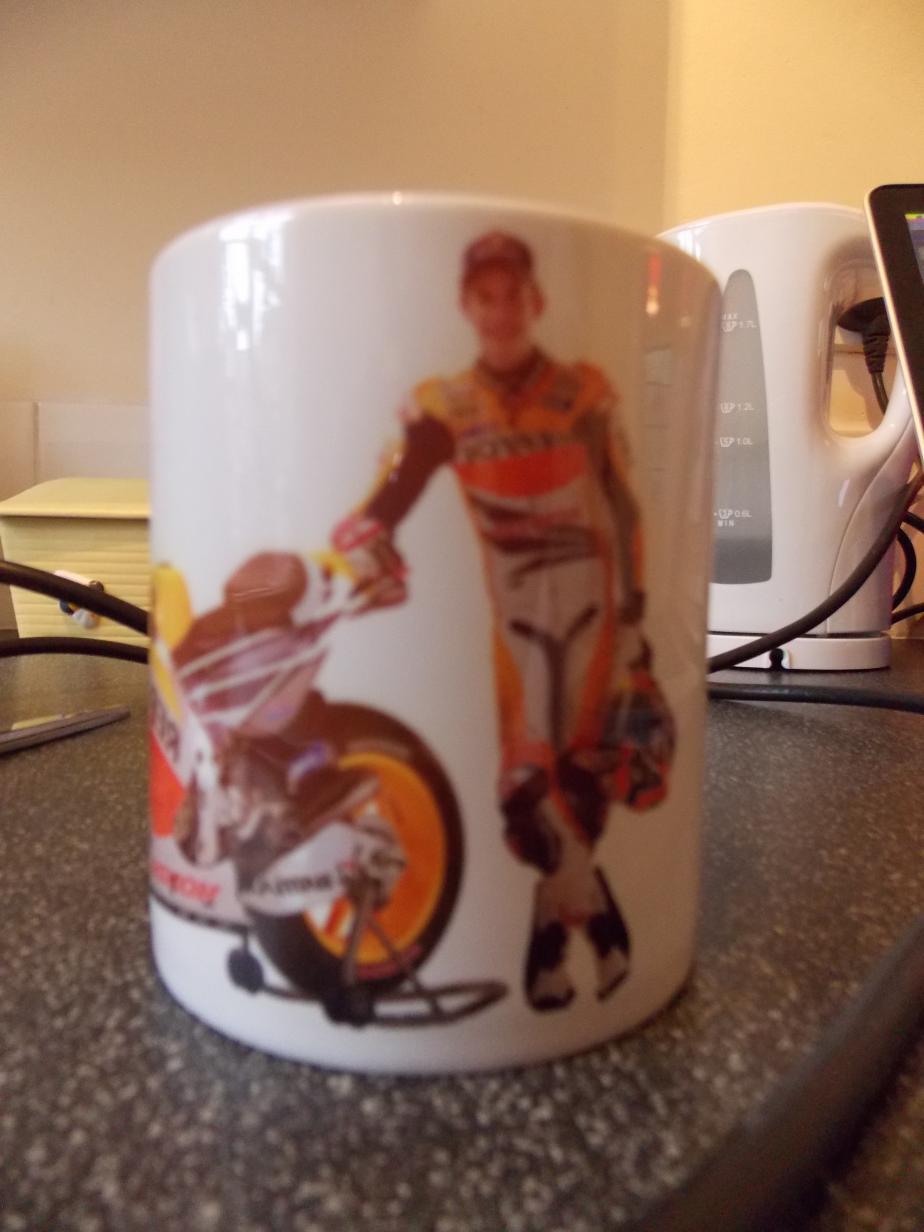

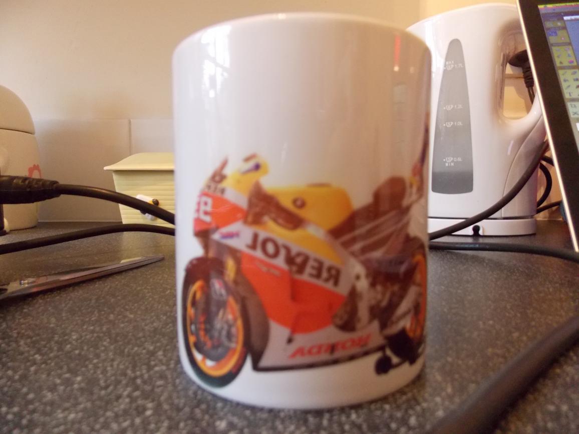

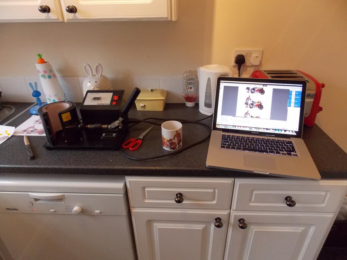

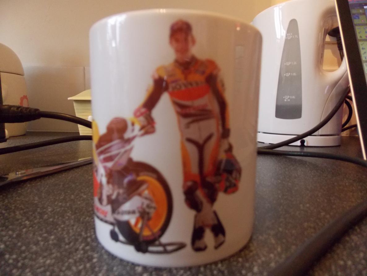

Hi Folks,
thank you for the comments and suggestions all taken on board!
So, here is my first mug press. Some issues: the image is a little blurred and the top of the mug (rim) has gone a brown/orange colour slightly? Any suggestions??
180 degrees for 3 minutes and let press return to temperature before countdown room ambient temperature and mug too... The sublimation seem to work so perhaps its the image or the print???
Cheers,
Keith
[ATTACH=CONFIG]2773[/ATTACH][ATTACH=CONFIG]2774[/ATTACH][ATTACH=CONFIG]2775[/ATTACH][ATTACH=CONFIG]2776[/ATTACH]
Cheers,
Keith

Re: Photoshop Elements 12 and Sawgrass Profile MAC OS X 10.9.3
Start the countdown as soon as you close the press, assuming the mugs are at room temp then this should be fine.

Hi Pisquee, I will try that does pressing for too long damage the image (make it blurred then) Elsewhere I was advised to let the press return to temp before count down?pisquee;88767 wrote:Start the countdown as soon as you close the press, assuming the mugs are at room temp then this should be fine.
Yes, over cooking can blur the image, and burn the ink affecting the colours.
We press at 200 degrees for 200 seconds, counting as soon as the press is closed. As soon as one mug is removed the next one is put in - we make mugs in large batches, and want a constant workflow, not waiting around for presses to reheat up.
Hi All, here's a link to my first mug. Any tips on why it's so blurred?
https://www.flickr.com/photos/22251687@ ... 796097580/
arthur.daley
- Posts: 538
- Joined: 19 Oct 2013, 14:38
Hi KeithKeith Coppuck;89256 wrote:Hi All, here's a link to my first mug. Any tips on why it's so blurred?
I notice that the image on the mug is back to front - I know this is a long shot but, you def have the paper the right way around? ie printed side to the mug!
regards
Arthur
