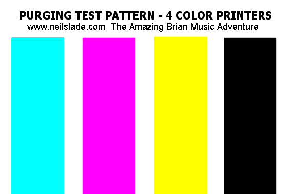

On the back of your cartridges you will probably have 2 bungs, one for refill, one for venting. If the vent bung is still in and not replaced with a vent one or left open then that could be your problem. I assume your epson runs on a vaccum to draw ink and not positive pressure.
The other thing you can do is find a CMYK print chart that will print a page with just the pure colours for your cartridges being printed over an entire page as columns. This will show if you are having a poor feed from one of the cartridges.

Yeah I've got one of those and a grey chart to help identify the shift in colour...I'll print that off later.
- vB_ID:2586
- TestPrint4Color.jpg (20.98 KiB) Viewed 24 times

I printed the CMYK chart above using Paul's profile and get solid black, bright yellow, dusty pink and pale neutral blue.
If I let the 'printer manage colour', the printout is much more saturated, the magenta is dark red and cyan is dark blue.
