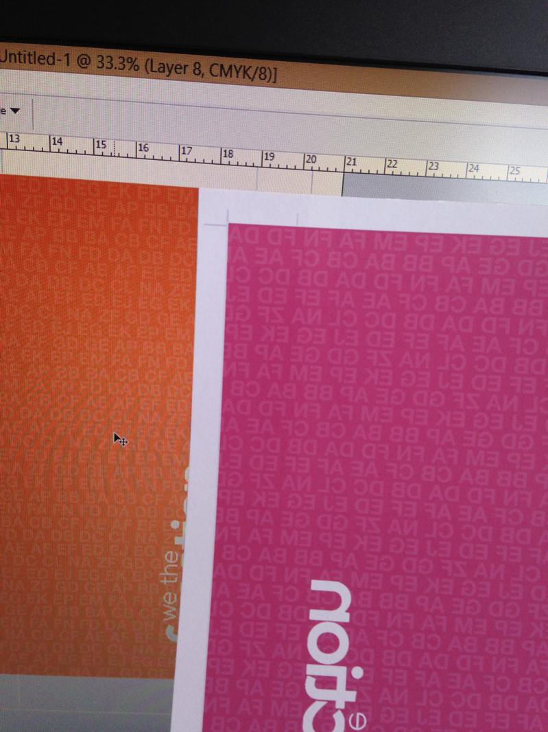

Sorry to hijack your thread Kaso but im having issues with my printing and I can only guess it has something to do with my profiles but I have followed every step. Below is a picture of an orange design on my laptop and the print beside it which is pink, any ideas???
Thanks in advance

Re: ICC for Ricoh SG7100DN with no SUBLIJET
Hi Oaten
Firstly, have you done a nozzle check?
Second, ensure your image is set for CMYK (just in case this is making a difference).
Treble check that you have installed the icc profile and made all the changes required (Sawgrass website will be able to show you that part).
Make sure that you are printing on the correct side of the dye sub paper (should not make a difference but worth checking).
If you do all the above then post your results it may help, I am not the best when it comes to this sort of thing and there are other members here that know a heck of a lot more.
Hi Socialgiraffe,
I done one early and the standard stepping lines but all connected etc.
I had my image in CMYK but after speaking to Sawgrass they told me its better to have ot set to RGB which I thought was odd!
I uninstalled and reinstalled the ICC profile and made sure the settings were all correct.
Im also printing the the white side of the paper.
I will change it back to CMYK as since ive reinstalled the profiles ive not printed using CMYK.
Cheers for the tips I will post me results tomorrow
The printer driver will expect an RGB output, so your workspace should be set to RGB, ideally Adobe 1998 RGB.
Are you using Sawgrass inks? if you are then their ICC profile should get you a lot closer to what you are getting (assuming your monitor isn't crazy!)
Is the print beside the monitor in the picture still on the transfer paper or transferred onto something? The colour will change once transferred, although not as much to turn pink into orange!
What graphics software are you using - can you post screen shots of its colour management settings?
