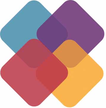

I've Been asked id I could do a logo on black t shirts, it's 4 colours but they overlap at the corners and the colour beneath shows through! Is there a vinyl that could do this? I could do it with transfer paper but think a vinyl would be better. All ideas welcomed.

Could you post a picture of the design?

depending on the design you could do striping to mix the colours in a sort of pop art way, means more weeding and may not be the effect you're after but it's an option

Here's the image. ideas welcomed as not sure it's possible with vinyl.

Ideally needs to be printed, as there are 8 colours and not 4. There are people on here who could print and supply that for if you if you ask.

do you mean DTG?

DTG would work but also transfer paper depending on the budget/quality you are after. I personally think you would struggle with vinyl as like Jason said, that is 8 colours, not 4.

Looking for high quality but never been happy with the transfer papers I've used. I've even tried WOW (not with white toner) but didn't feel happy with the end result with that either (though that could be me and/or my press).

WOW was notoriously hard to work with IMO but I have seen the new stuff and it looks very good, you do need a white toner printer though :( DTG might be the way to go for you then depending on quantity or even screen printing.
