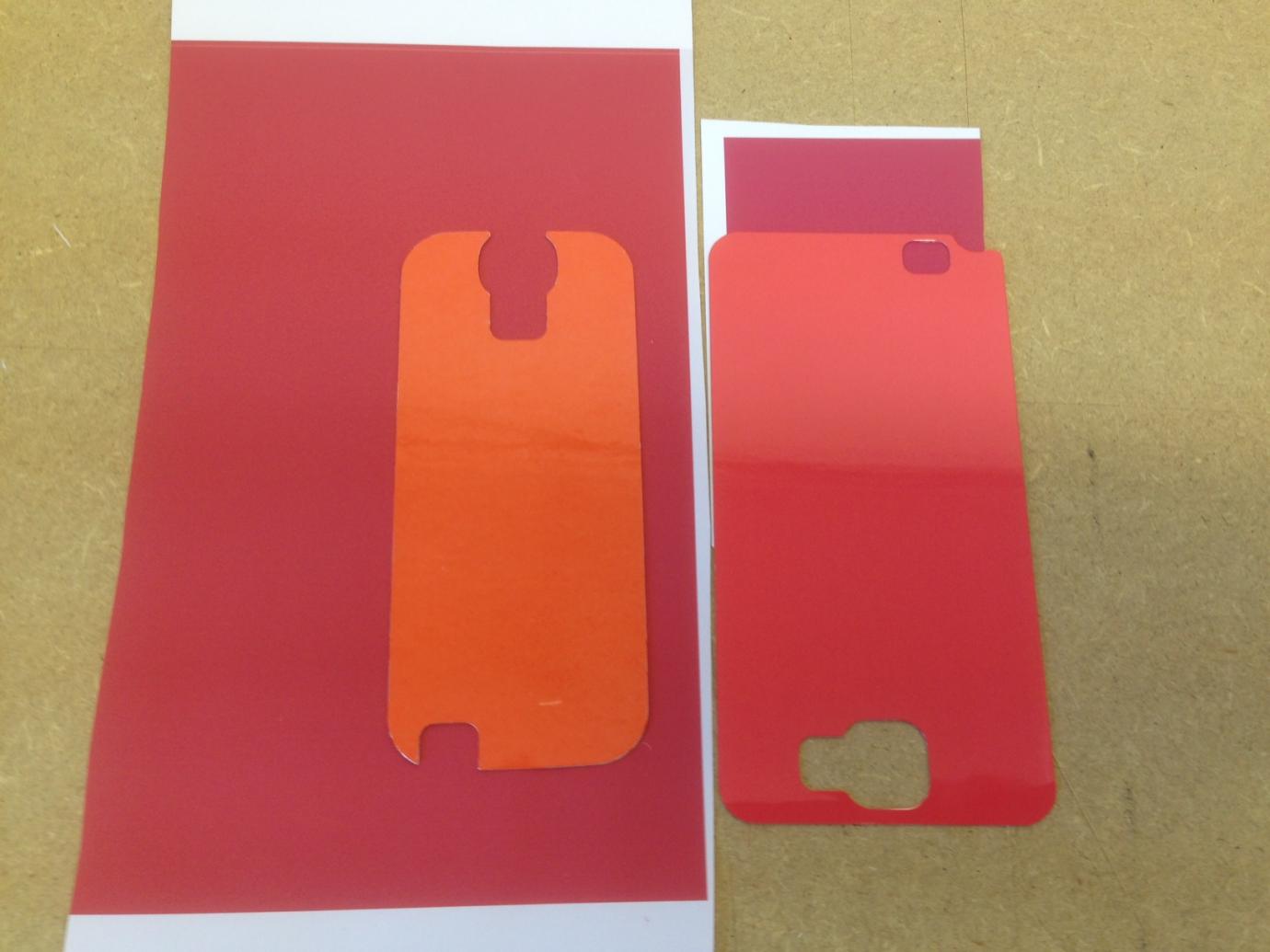

Ok, tried changing the profile from Pauls to the original and it was still orange, then tried printing the same red square on our A4 Ricoh. The red came out a lot redder. Is it the profile or the Epson 7890 printer?
Attached is an image, the one on the right is from the Ricoh.[ATTACH=CONFIG]2495[/ATTACH]

Re: Red looks orange on faux suede
Well... Then you know is not a blank. Wait till i send you edited profile for colder white.
I would guess that either something has gone wrong with the creation of the ICC (print settings used for the printing the test charts) or in how you have photoshop set for colour management.
