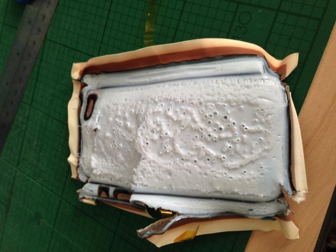

Re: Printing help needed
Ok I just ran a test print running at 190c with 1 heating plate running for 9 mins and this is the result I got
[ATTACH=CONFIG]2481[/ATTACH]
I also noticed slight sticking of paper to the sides of the case. Anyone able to give me advice on what I need to change? I feel im getting so close and I think this is prob the best print Ive had so far.
Thanks in advance
Thanks in advance
Hi Oaten,
When I mentioned "both heaters", I meant you need to turn on both heating plates...However, your press looks really bad at 9 mins and 190C with only one heating plate...And I notice on the left edge of the case there's paper residue...
I would advise for the next press, you try with both heating plates and 190 C for 10 mins. The funny thing about this pressing machine is, the second or third press will usually take less time (about 30 seconds less) than if you were to press when the machine was just turned on from cold state. If you press with the same 10 minutes, you will start getting color fade and you risk the case getting shrunk.
If you try with both heating plates on and you're still getting the same result, then it seems your paper is a bit at fault..Do you print it on the printable side? I do not have truepix paper since I'm not in the U.S...Nonetheless I know that there are at least two kinds of sublimation paper: one remains "wet" after you print it, The other one dries almost instantly. For me, both have pretty much the same transfer quality.
Good luck!
Good luck!

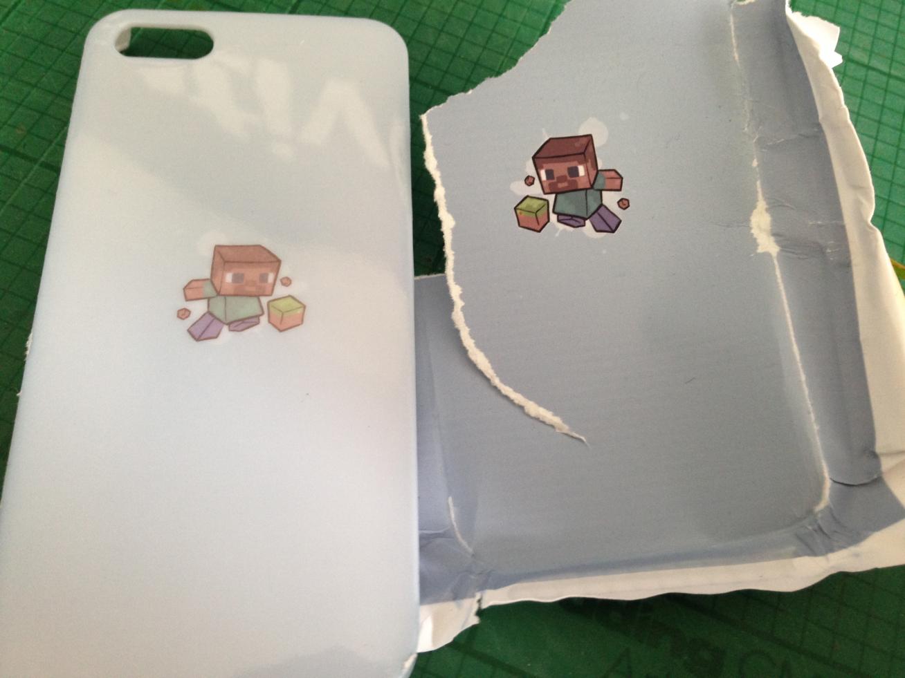

[ATTACH=CONFIG]2482[/ATTACH]Looks like its my supplier because this case surly shouldn't do this at 190c 2 plates for 10mins
