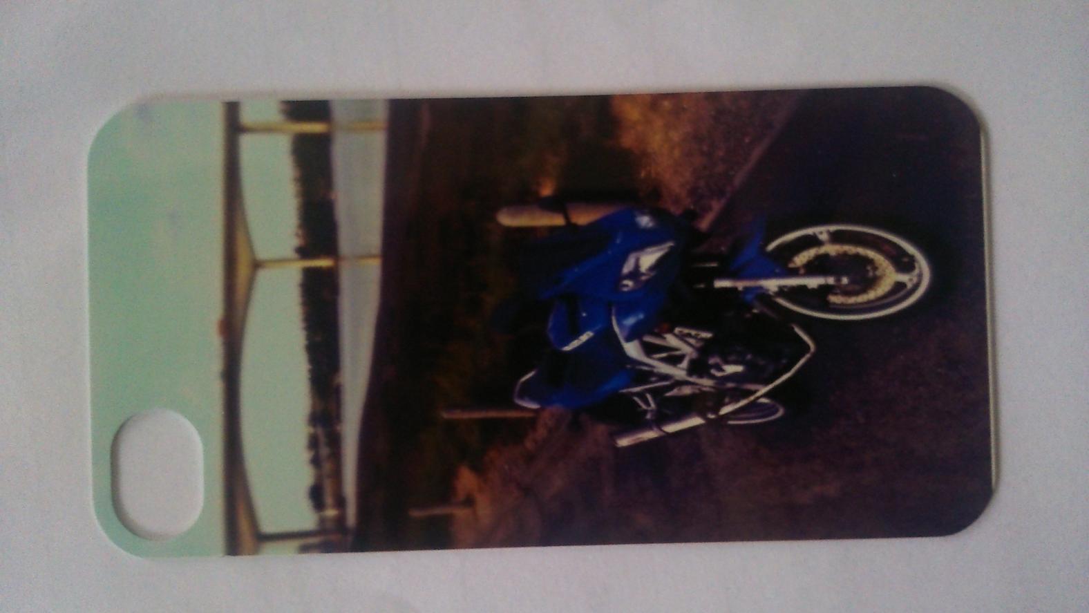

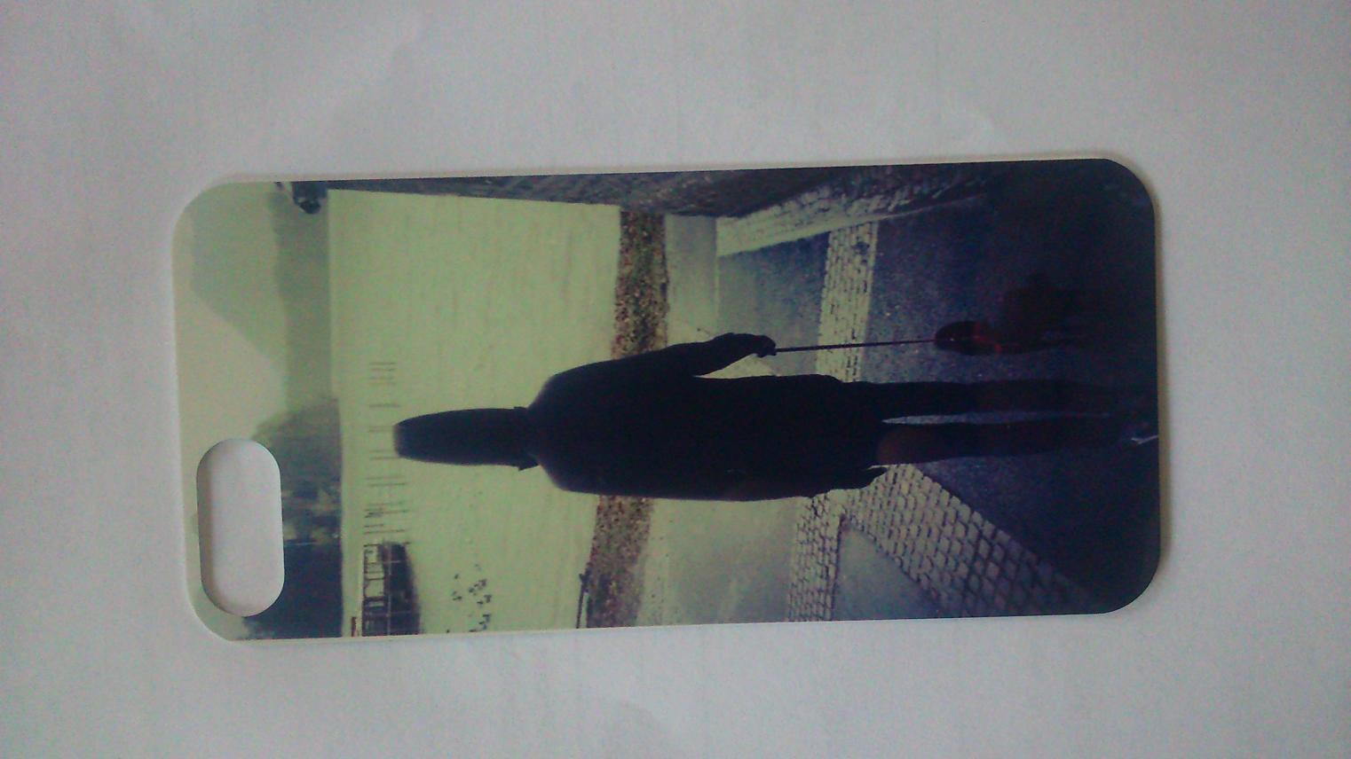

i've tried just using the brighting feature , but im not a whizz on photoshop i've attached 2 images and made product[ATTACH=CONFIG]2466[/ATTACH][ATTACH=CONFIG]2467[/ATTACH]
ive made minor adjustments here but in general all the images are alot bright on screen than when printed ,
im on bms paper ricoh 3110 icc by paul printing qat 175 for 50

images look like paper is printed on the wrong side also try trupix paper are you using sublijet r inks if so you dont need icc unless using mac use powerdriver software from sawgrass instead
Re: personalised phone case
If OP has a custom ICC profile made, then switching paper would then change his results negating the benefits of having a custom ICC in the first place.soulclaimed;84349 wrote:images look like paper is printed on the wrong side also try trupix paper are you using sublijet r inks if so you dont need icc unless using mac use powerdriver software from sawgrass instead
Having a custom ICC should give better results than the generic ICC that Sawgrass provide as a raw ICC or through PowerDriver.

i just meant that most use powerdriver as do i and with trupix get good results custom icc is not required as colour reproduction if using sublijet r and this setup gives good results, the graininess of the image and the dark print could suggest wrong side of paper as i have had the same issue myself, if its the type where its hard to tell the difference lick your fingers and dab each sidethe one wheres its shiny is the right one, put paper in your tray shiny side down
