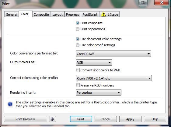

As Justin said - recheck your CorelDraw settings. This happens if the printing intent (file/print/color) is set to "Absolute Colormetric". It's better set to "Perceptual".
[ATTACH=CONFIG]2430[/ATTACH]

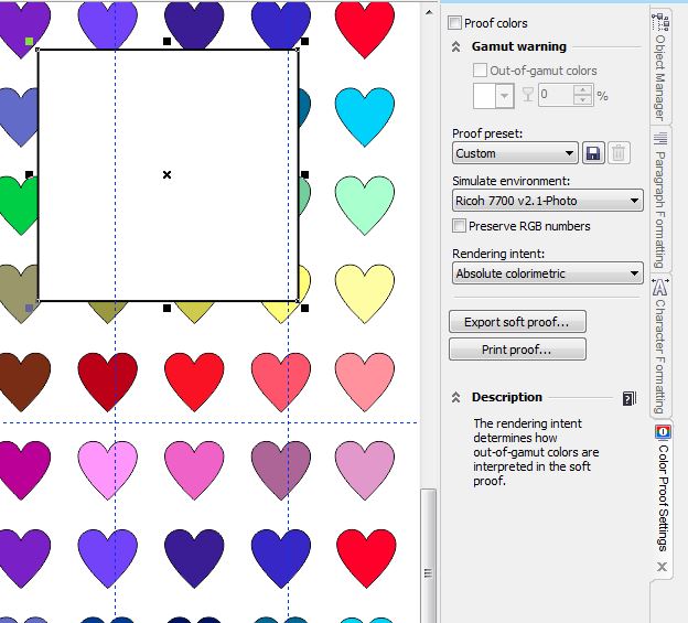

You can check if this is the cause of your "blue" tint. In CD - switch on tools/color proof settings to get screen below. Set to your ICC profile & "Absolute Colormetric". As you can see the square looks white.
[ATTACH=CONFIG]2431[/ATTACH]

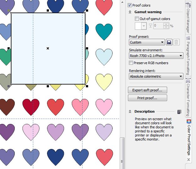

If you switch proof colors "on" (there's a check box at the top) the white square will change to blue because of the rendering done by the "Absolute Colormetric" setting. Change this to "perceptual" or "relative colormetric" and the square will be white.
[ATTACH=CONFIG]2432[/ATTACH]
Try it - if yours doesn't turn blue then the cause is probably something else.

Thanks for all the help so far. Just to clarify a couple of things JOHN G & Earl. It only happens with imported images, if I create the text myself it's fine. Using BMS Subli paper.
My setting was Perceptual but ....... schoolboy error. The profile set up clearly states make sure all the Orange & Grey arrows match the diagram, guess who had no orange arrows set
Not tested the result yet but will keep you posted.
