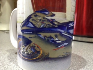

Hi all I am having a issue printing this picture to my mug I am a novice at this please can someone tell what I am ding wrong

no when printed it looks the same as it does on the cup

Comparing the two photos, on my screen, it appears as though anything that's black/very dark is not printing properly.
Just wondering if the black head is blocked - would be worth doing a nozzle check.

Looks like the black has totally gone from the image. I'd clean all the heads a good couple of times and do a test print inbetween each one.

I think I have sorted the problem now printing in the wrong setting must of been having a blonde moment lol
