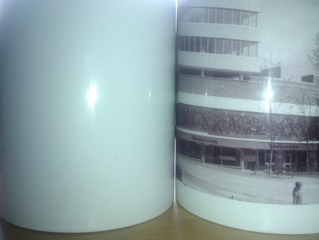

I've lined up a a few of the mugs and there is a little bit of wavyness (is that a real word!!) but I assumed with the spongy bit of the blanket that it would have it well covered, could it be a pressure problem? see below:
[ATTACH=CONFIG]2364[/ATTACH]
I will try printing a mug the other way round and see if that makes a difference.
The lines on the flower mug are strange, I always make sure my transfer are nice and tight around the mug, or could a slight wave in the top of the mug cause the paper to crinkle?? I don't know, just throwing ideas in the pot

I've just placed a steel rule against the flower mug, and where the crinkles the mug seems to curve inwards there, so maybe that could be a reason, this is also the case at the very bottom of the mug.
Would the blanket not be able to curve round these areas?? am I not using enough pressure doyou think??
thanks
Dan
