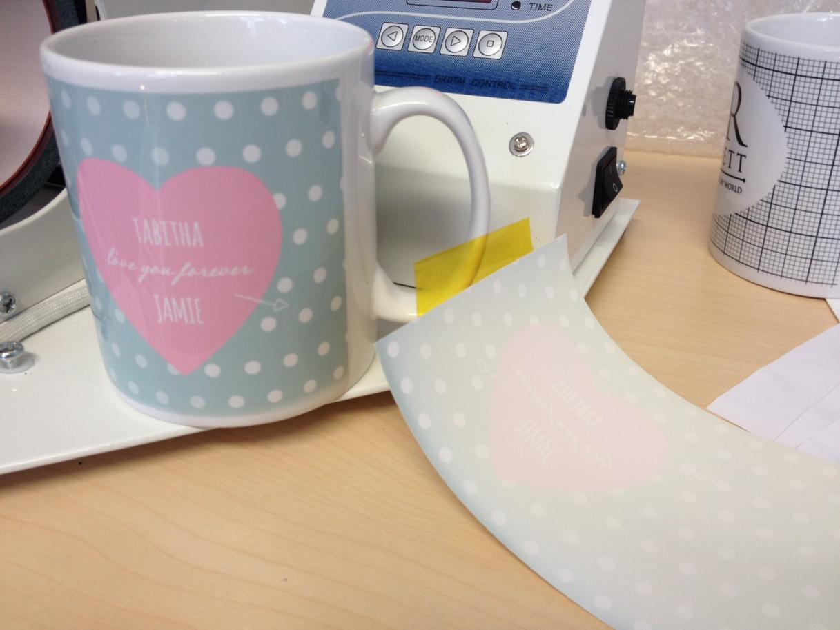

I am wondering if anyone can offer their valued opinion on this problem (I am sure I have read it mentioned on the forum but am struggling to find it).
Excuse the rubbish photo - hopefully you can still see the problem. The bottom corner is faded/blurry and the paper is also discoloured at the bottom - would love to know what causes this please?
Temperature 338/170 and 120 cooking time.
[ATTACH=CONFIG]2369[/ATTACH]

Re: DF12 - temperature setting issue
Don't panic!
The bottom of the mug takes longer to get hot as obviously you have a nice lump of ceramic there. My suggestion to rectify this is twofold. Firstly place the mug in the press so that the open end is facing your control box. Secondly, rather than having the mug bang in the middle, move it slightly toward the control box. This should result in the bottom of the mug taking a little more pressure. You could pop the time up by 15 seconds as well.

Sorry, I thought I had replied to say thank you Scotty. And yay! it worked
