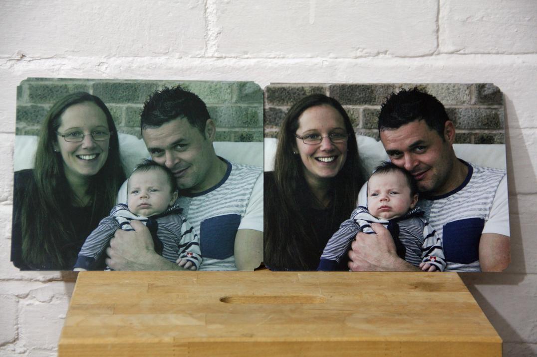

[ATTACH=CONFIG]2330[/ATTACH]
Well cracked it in the end.
I will go through this in stages as it's the way my mind works.
Problem Suddenly images have strong green colour cast.
What Changed - Printer was moved and turned on end.
What else - When fired up after move spat ink out, this was when colour cast happened.
What was my response - Look for something that's changed, found lines full of air bubbles.
Remedy - pull out all cartridges, re-insert, initiat fill, nozzle check (perfect), re-profile, print.....still green.
Response - repeat process ensuring every stage is exactly as it should be, same outcome, green colour cast .
Now what?- Read, ponder, question, read, ponder etc.
Learn - Green colour cast caused by no profile application. So read, watch videos, question, all was exactly as it should be.
Now what? - Read, ponder, question...etc.
Learn - Green colour cast caused by lack of magenta, nozzle check...perfect. Although that doesn't use much ink..
Thinking - When printing magenta draw is much greater than on a nozzle check. ink drawn by vacuum pump, vaccum pump must work as print is good just wrong colour.
Mad cap idea - Air vents on cartridges blocked?
Solution - Pull off little air vents (7, total value less than 1p!), now run ink test printing a thick long line from each cartridge...all good, nozzle check (as expected - all good), re-profile, print image WOOP WOOP, normal quality returned!

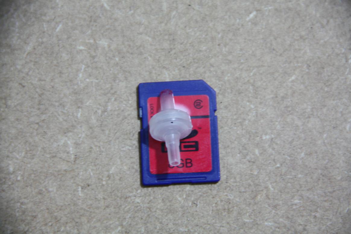

So 2 weeks of head scratching, muttering, goodness knows how much searching of the internet, and the problem was a poxy blocked air vent! Yes that thing sat on a memory card...
[ATTACH=CONFIG]2332[/ATTACH]
Anyway sorted.
