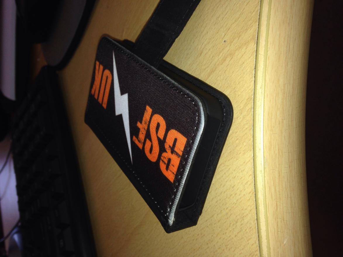

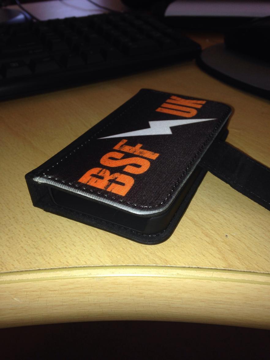

Is there any method to colour the edges of the iphone flip covers , as Ive just done one but the white edge looks rubbish :frown:
[ATTACH=CONFIG]2211[/ATTACH]

Black laundry marker pen.

i would've thought they should sublimate right to the edges...have never tried one myself though. had you enough bleed on the design?

You could try a silicone pad over the flap with high pressure and longer time to allow enough heat. The soft silicone should form over the edges a bit but you probably won't get all of the white.

spongerobinson;79734 wrote:i would've thought they should sublimate right to the edges...have never tried one myself though. had you enough bleed on the design?
They sublimate to the edge but the white goes round the edge . I tried another with a silicone pad over it so it wrapped round the edges , but not really a lot better ............so black sharpie was used !!!
Note to self - only do light designs on these cases
