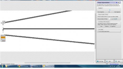

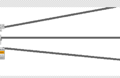

Hi Guys,
Been using my Promacut PC720 for a while now and all been going well but recently whenever I cut anything curved then I get a very jagged cut on the vinyl. I'm not too hot on settings but have tried adjusting speed and blade depth but doesn't seem to help. Im using WinPCsign so if anyone is using that software maybe they have some settings that can help. Ive attached a couple of pics to give an idea of the issue as I know its quite hard to explain, hopefully they will help.

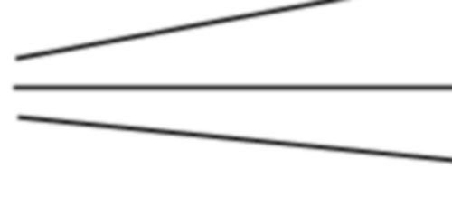

Looks a bit like that the original lines were not drawn straight to begin with. Ive tried to do a pic to exaggerate the effect. If you know what I mean? But also looks like yourt graphics are not hand drawn into a programme? They are already made graphics which you just imported into the app?
