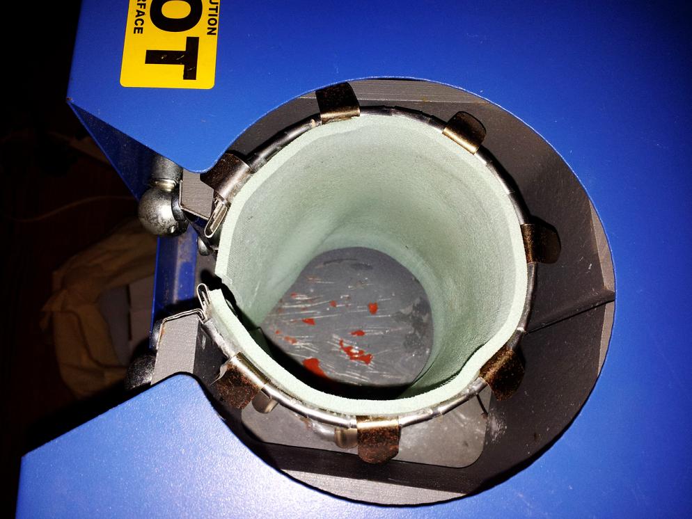

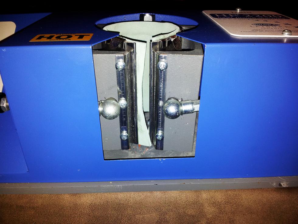

I just second hand Jarin HF2200 mug press which just arrived. When I opened a box I've noticed that blanket looks like DIY blanket. Looks very poor, is very slim and looks absolutely different to compare with original one.
I already opened a case against seller but because I heard a lot of good opinions about that mug press I'm considering to keep it if I'll find a place to buy a new blanket.
Does anybody know where can I buy a new blanket for that mug press ?
Also want to ask if it's a good idea to keep it and replace a blanket (I will make sure that seller will pay for it) or should I return it to seller ?
Press seems to be working fine except that blanket.
I paid 175 for it if that helps :confused:
I attached pictures below to show You what I mean:
[ATTACH=CONFIG]1996[/ATTACH][ATTACH=CONFIG]1997[/ATTACH]
Thanks for any help

http://www.europa-leisure.com/ do spares but they are not cheap. Definitely the wrong blanket. It should have a silicon sleeve that curls over the top and bottom of the blanket. I've got a dead 2200 that might be good for parts the electronics went bang when I spilt some ink on it, but the blanket should be fine.

Depends how much a new blanket is going to cost, the parts that I enquired about were very expensive, the control box(glorified timer) Was about £143 and the silicon sleeve for the hat blanket were £27.00 a pair. I've still got a brand new one and the one on the blanket was hardly used before the bang. Like I said they are very good presses when they are working. Wish I could afford to get mine up and running again. But I resent paying that much for a timer.

socialgiraffe I've tested that mug press and it's working fine. It keeps temperature between 193 to 198 while is set to 195 so its +/- 2 degrees. It's heating up so blanket works but looks weird. I'm not sure if heating element need to be replaced or just that sleeve around it ??? I have never had any mug press before so don't know anything about it. Timer counts fine and gives "beep" when finish.

I found very similar blanket:
http://www.subli.co.uk/shop/dye-sublima ... d_675.html
It's for DK3 mug press but internal sleeve looks almost the same as mine except poor shape :D

Dave271069 I have got it from eBay. It was normal auction not a bargain or something. He listed it as solid mug press in good condition. He also listed it with 112 x 84 pixels picture - thats why I was not able to see that blanket.
I would never buy it if I was able to see what i get. I've had to trust in discription.
At the moment I'm not able to print any mug because I just bought that mug press and don't have any mugs and printer yet.
I would also ask what type of material has been used for that blanket ? I'm asking about that because blanket for George Knight DK3 mug press seems to be made from same material (thin like mine).

Re: Jarin HF2200 blanket
We did have a mug press of this model where the blanket had been replaced in a similar way, and although it was obviously not the same as it was originally, it still worked fine. Looking at the more recent presses of this model, the blanket looks a lot different from what they used to mind.
