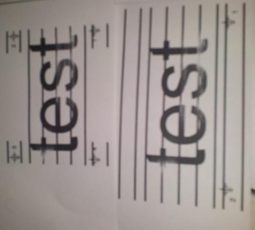

In FlexiSignPro 10 I am getting my head around contour cutting so am doing some testing - I have installed my Subli printer as well as my General printer into the Production Manager and they both work as expected.
The problem is this, from both printers:
[ATTACH=CONFIG]1967[/ATTACH]
As you can see, these black lines are not wanted - I have been messing for hours now and think it's time to tap into the members experience.
I have been through this many times, turning various makrks on and off but even with all extra marks turned off I still get this.
Any idea's? :confused:
Update: If I print via 'Rip and Print' the lines are there but if I go File - Print they are not ! BUT, if I print this way I do not have registration marks :( which is another sore subject 'Registration marks' as all I have are 'iCut Marks' which are 5x splodges.

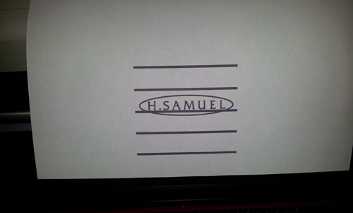

Funny you should say that Paul, I didn't have any registration marks on that first one but the second (right) I had 2x registration marks and the Third (Left) I had 4x Marks and look what happened to the lines !
What on earth is going on - I have spent all day on this :(

Re: FlexiSign 10 Black Lines over everything.
looks like error in software. maybe reinstallation will help?

Post by dazzul »
That is a system Flexi have in place to combat illegal copies of there softwear.
Return it to your supplier for a full refund :)
I had the same issue with when i brought one, found to be a very good looking reproduction returned to the seller for a full refund.

I was going to say the same thing dazzul...... Illegal copies have full functionality but will print with the black lines rendering the copy useless. Strange that SA do not inform you about this so Im just wondering where you know about this dazzul? hahahahaha.... hmmm.... strange that I know about it aswell!... Just kidding!.... I read on some dodgy website about this protection. As dazzul says... return it to the person you purchased it from and demand another copy or your money back.... I would also, if found that all his copies are the same, report him/her to the appropriate authorities.

So, I should be ok now - bought a Digitus Serial to USB adapter so I can set up my registration marks on my Liyu and a legit copy of Flexistarter 10 (As I said, a great deal at £67 with dingle dongle of course).
No more black lines :)
