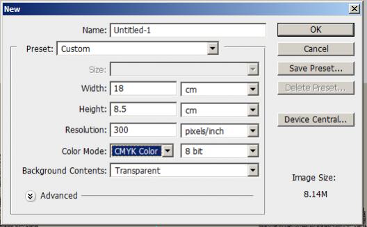

Try the following:
Start a new photoshop file with the settings exactly as attached.
[ATTACH=CONFIG]1930[/ATTACH]
Insert pictures, text, anything you want into this file. If you insert images which need resizing by all means do, but make sure you increase the zoom level of your document to 100% to check that the image is not pixelated. In an ideal world you would only ever decrease the size of your images as increasing them will pixelate them more. If you add text make sure that if you want to increase this you do so by increasing the point size within PS and not by scaling any rasterised type.
Once you get something that vaguely resembles something to print and test then do so.
If you print this using the correct ICC profile then it will sublimate well (depending on quality of ink, paper and blanks etc).
If the above works then I would suggest a book on Photoshop might be your starting point
