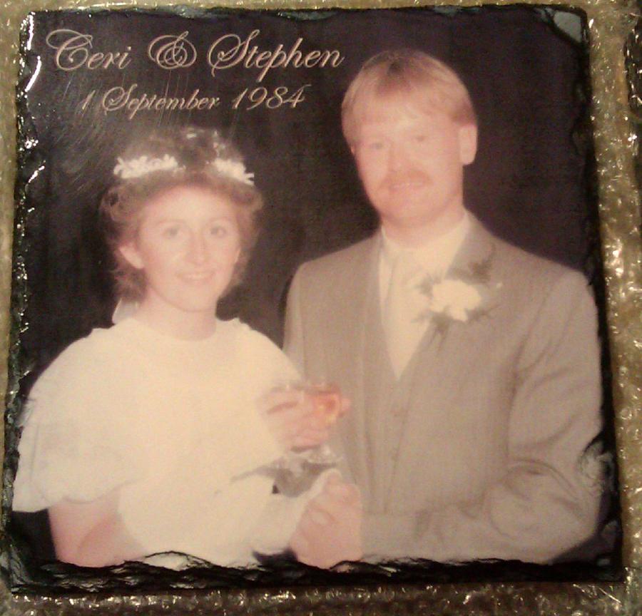

Thanks for replying. I have viewed your video of the slate on many an occasion and I follow your instructions to the letter; I view you as the expert on it, and I posted a pic of my very first slate result on this forum because I was so pleased with it.
I've done a different photo slate today and redone the first one as I found I did have the required size. I found that the faulty one is a matt finish stright out of the box and the other one I did today had a high gloss finish. They are both rock slate ones as you used in the video, and the glossy one has come out so well. I'm wondering if I have had a faulty batch as a number of them are not glossy at all. Do you know if you can buy both matt and gloss finish. If so, the matt ones are really poor quality. I will try to publish photos of both matt and gloss to show what I mean.
The one below is my first ever attempt, all the ones since have not been as good.
[ATTACH=CONFIG]1900[/ATTACH]

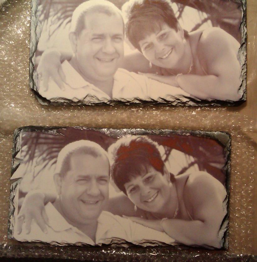

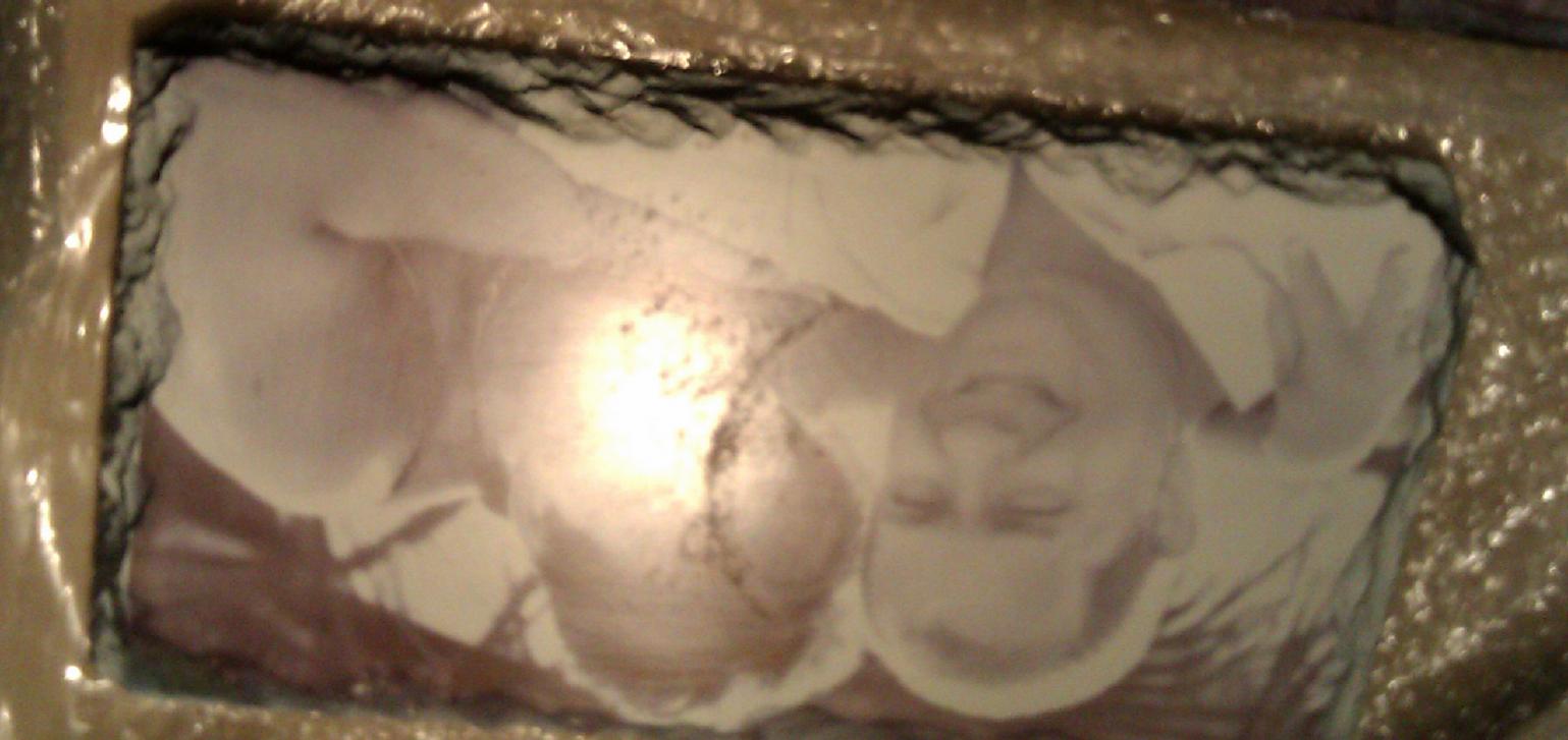

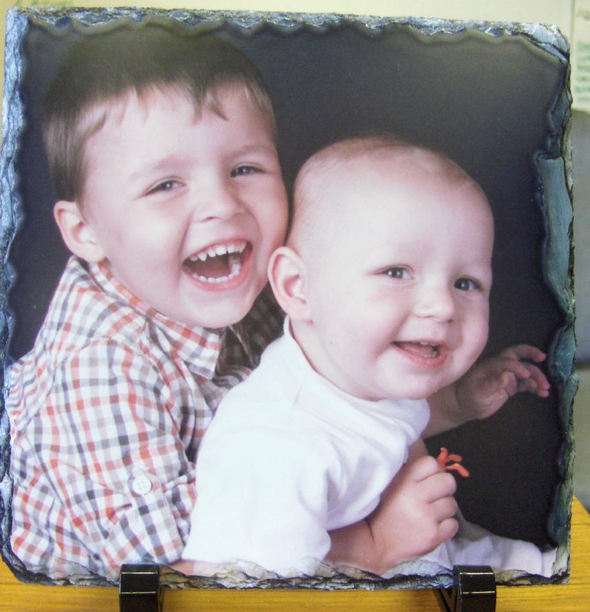

As you can see on the first photo, there is a circular mark which wasn't obvious before printing. But when the light is on it, it's very obvious. The second photo is with a glossy slate from an old photo, so pleased with that one. The 3rd photo shows another slate I printed trying to get the blacks dark and resulted in areas of overcooking in the ladies' hair.
Any comments?
[ATTACH=CONFIG]1901[/ATTACH][ATTACH=CONFIG]1902[/ATTACH][ATTACH=CONFIG]1903[/ATTACH]
Any comments?
