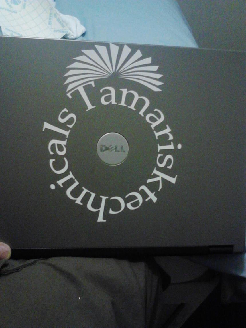

Yes the blade will turn in the holder think they will be the same, I meant the vertical movement was not enough. I get the impression that there must be an amount of height clearance, but not sure what?[ATTACH=CONFIG]1878[/ATTACH] just done this and stuck to laptop lid think I went to fine in the detail, but it did a decent job. It is just about learning the cutter and Signblazer.
But learning.
Adrian
