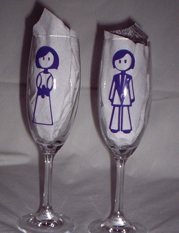

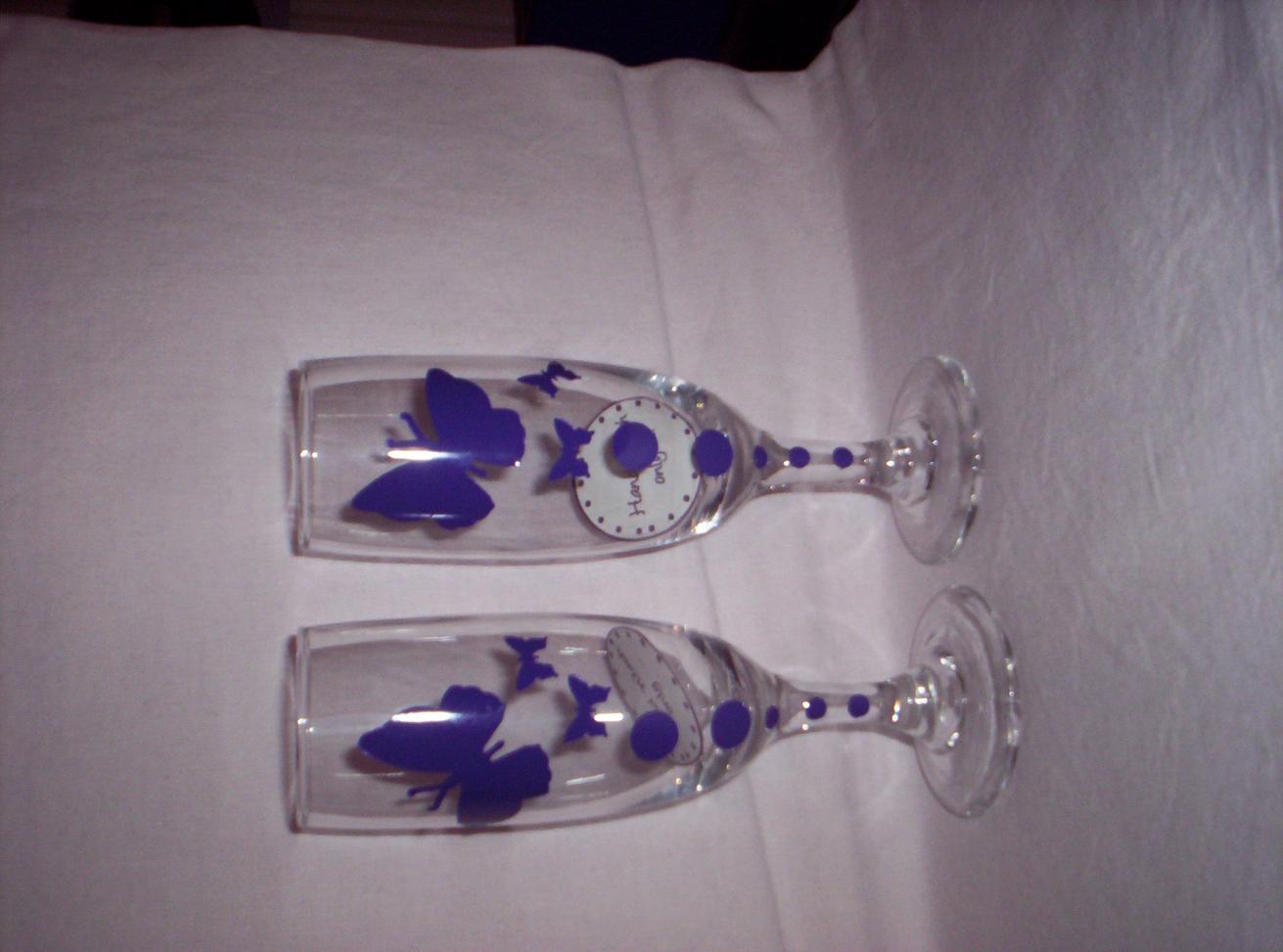

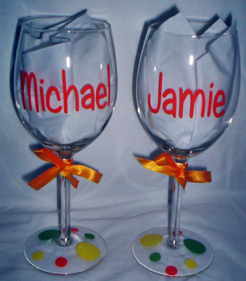

Vinyl can go on glasses etc. It doesn't need to be heat pressed. If left to cure long enough...about 1-2 weeks it should wash well. I know people that have done this and even washed them top shelf dishwasher with no problems. Use an outdoor vinyl [ATTACH=CONFIG]1814[/ATTACH][ATTACH=CONFIG]1815[/ATTACH][ATTACH=CONFIG]1816[/ATTACH]
Here are some I have made in the past. The bride groom and the name ones were cut out with a cricut The butterfly ones where just punched out using a craft punch. Then just peel of backing to reveal a sticky side and just place on item Squeeze out any air bubbles if need be.
- vB_ID:1816
- wineglasses1.jpg (90 KiB) Viewed 246 times
- vB_ID:1815
- 100_3458.jpg (92.72 KiB) Viewed 246 times
- vB_ID:1814
- bridegroom.jpg (37.86 KiB) Viewed 246 times
