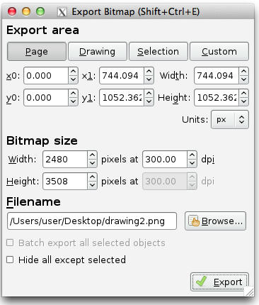

Just been trying out a text based design to press onto an iphone cover.
I designed the text in inkscape as a vector as that's the way I know how to add borders (linked offfset) around text. I saved as .png opened in photoshop and printed, However it came out very pixelated. Don't laugh at the noob ;)
What have i done wrong? lol
I assume it's got something to do with the size of the design originally in inkscape? I really don't know how to correct it.
I created it with a page size of 7x11.5cm for a close match to the size of an iphone 4 case which gave me a template to design on.
Re: Pixelated text when printed
dont use "save as" try to use "export to bitmap" and set dpi for 300
rob88
Posts: 13
Joined: 01 Apr 2013, 22:03
Post by rob88 »
Ahh of course!
I knew I'd done something wrong.
Just came out perfect, much appreciated!
