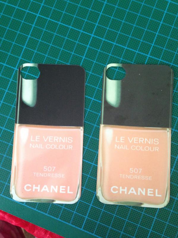

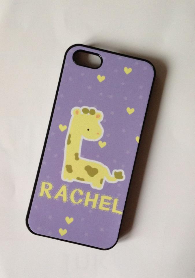

My main problem is the grey turning green, i've seen that a lot of people have trouble with this and i wondered if it could be conquered by adjusting pressing time and the temp?
[ATTACH=CONFIG]1752[/ATTACH][ATTACH=CONFIG]1753[/ATTACH][ATTACH=CONFIG]1754[/ATTACH][ATTACH=CONFIG]1755[/ATTACH]
Here's a couple of examples. Total fail with the pink, the first one in the actual phone covers is my second attempt and the second is the first. It's not the right pink. But the glass is tinged green still.
But the giraffe cover seemed to turn out fine.

You will be able to improve the images, but because of the cheap ink and the unbranded paper you are going to have to faff around to get the right temp and time. Which will probably cost you more than a new set up.
It is a false economy to say "I am starting up and need to purchase the cheapest possible kit" it will not last, will not serve you well and ultimately will probably be thrown away.
I am sorry as I know it is not what you want to hear but there is no magic wand on this, especially when working with unbranded and unrecognised equipment. Anyone offering advice on temps and times are just stabbing in the dark without knowing the specifics of the materials used.
Also, and as a side issue, I think you will find that the Chanel cover breaches copyright issues. For a new business it would not be good to go down this route.
