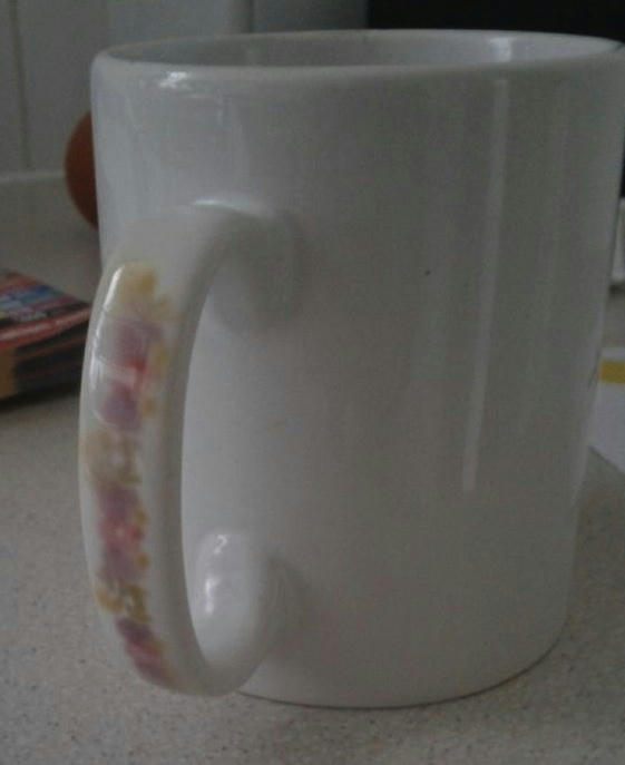

Toying with printing on mug handles. all looks good and working well. this one is the first and little fail but next one will be percet :)

I had a play with that as well. Decided time spent doing it versus extra charge for the mug .... didn't work out for me.
BUT I may revisit that idea.
Have fun with it Paul.
Janners.
Re: toying with printing handles
I tried it as well and although I got fairly good results the sharpness was just not as good as I require.
Try printing some feint lines (.5pt width) and then you will see what I mean.

Paul;68456 wrote:Toying with printing on mug handles. all looks good and working well. this one is the first and little fail but next one will be percet :)
What is it Paul, the print I mean ............. a pattern/flowers?
(I can't make it out?)
flowers. i will post better picture when i print something descent.
AdamB
Posts: 2044
Joined: 10 May 2010, 10:00
Post by AdamB »
Paul;68470 wrote:flowers. i will post better picture when i print something descent.
Ah, I see :)
Are you using a mug wrap on the handle and an oven?
yes. i use silicon wrap that i made myself and kitchen oven.

You can use a hat press attachment on some presses.

Andrew;68479 wrote:You can use a hat press attachment on some presses.
good idea Andew ............... it's the right shape!
I see an experiment coming on :)

I posted some pictures I did in a quick test in a previous thread:
http://www.dyesubforum.co.uk/vbforum/sh ... #post59465
Just taped the paper on as tightly as I could, no wrap. I think as mentioned above, fine detail might be a problem.
