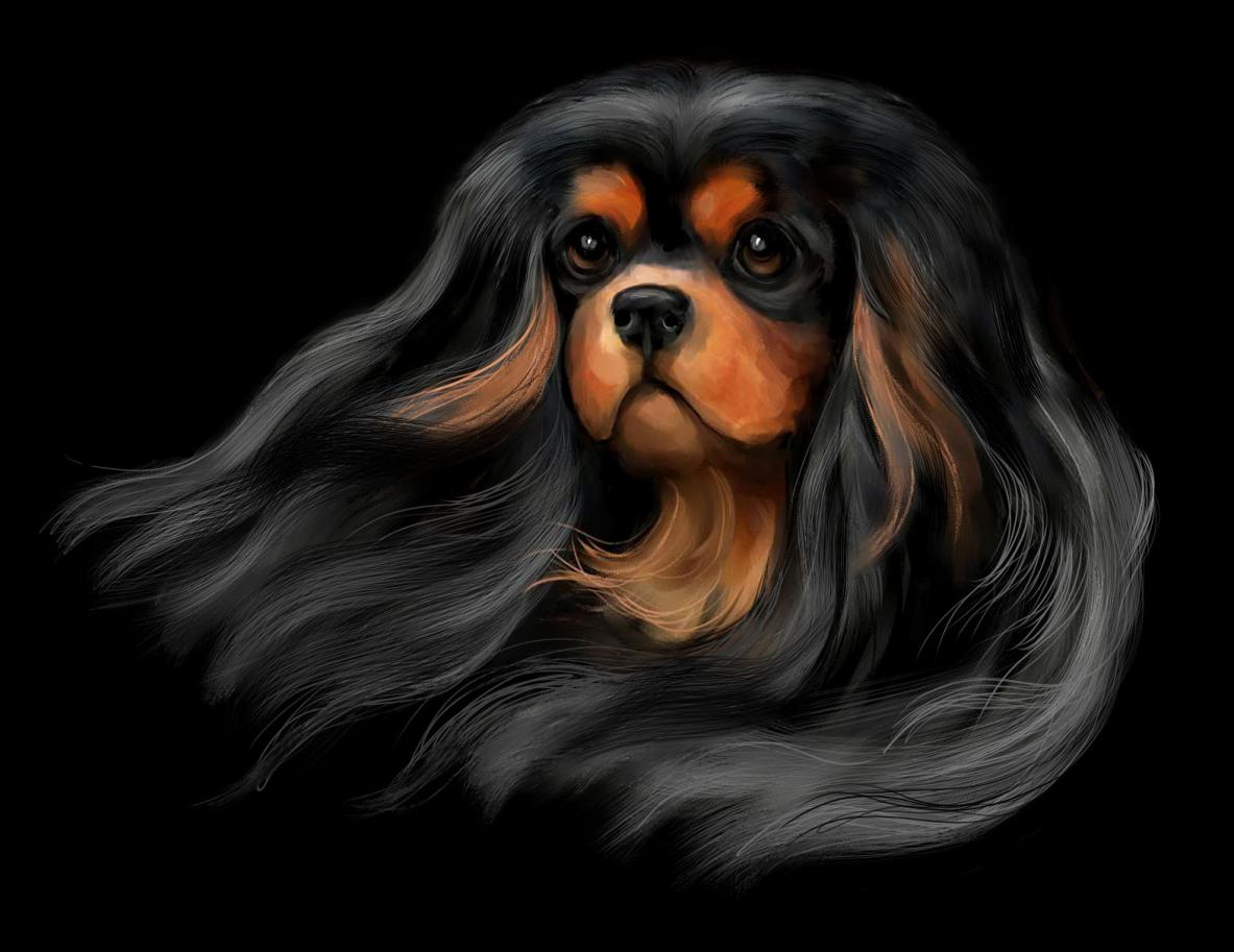

I have printed this image on a Ricoh Printer and the settings are correct. When I produced a mug the depth of colour and detail of the ears had been lost.
When I had a demo at xpress, they produced this onto a coaster and it looked perfect! Can anyone advise me what I am doing wrong please.
Thank you.

How does it look on the paper before pressing?

The colour looked fine, I was wondering if I was cooking them for too long!
Re: Colour Problems
It is probably to do with either temp or time presuming you are using decent quality mugs. Is there any way you can send a picture of the finished mug to compare?

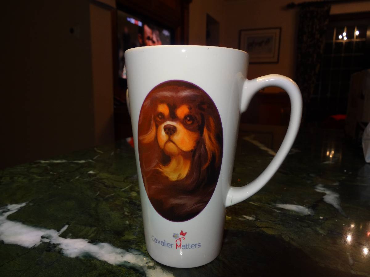

I will upload a photo of the mug shortly, the internet is very slow at the moment.
I use photoshop, I purchased the Latte Mugs from the Transfer Press and I used the Halogen Oven set on around 15 minutes.

socialgiraffe;63517 wrote:It is probably to do with either temp or time presuming you are using decent quality mugs. Is there any way you can send a picture of the finished mug to compare?
This is the mug, it is a bit washed out.

Re: Colour Problems
You are printing on the right side of the paper so no worries there and looking at your mug I would say it is a time issue.
Can you let us know what temp and time you pressed at?
