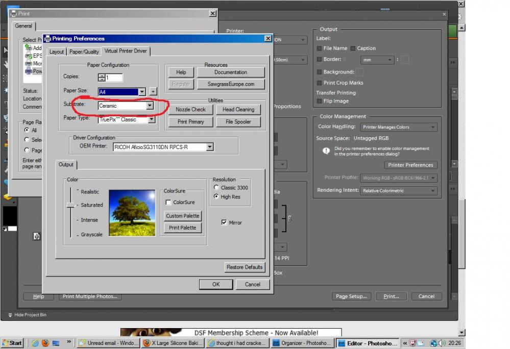

hi martin not seen that setting iam using the sawgrass powerdriver and only setting i have put in trupix paper iam not getting fading all over crisp and clean at the top its just down near the bottom
viccar
Posts: 837
Joined: 01 Nov 2012, 18:57
Re: thought i had cracked it
Post by viccar »
[ATTACH=CONFIG]1439[/ATTACH] You use the dropdown here to change what you are sublimating

Thanks viccki we will give that a go i appreciate the help as it is starting to get frustrating lol
steve 1
Posts: 142
Joined: 24 Dec 2012, 17:36
Post by steve 1 »
ok changed the setting to ceramic no fading at all but the coulers are lighter than they should be i e dog has dark hair on pic but when put on mug picture is clear but dog has light brown hair a little bit more help and we might be there using photoshop elements 11 just bought and installed not touched any settings thanks guys

hi brett thanks very much for your reply. what i meant when i said i had no tempreture guage is i dont have one to check against the reading on the press. my press is a sbo1 which is almost the same as the df1 from bms. i have the ricoh 3110 printer and using trupix paper and correct ink. what happend was i printed my first mug and it was very faint sowe went down the lack of pressure ian and viccki spotted on a photo i posted that the metal plates holding the heat blanket was grabbing the handle and so i could not increase pressure i turned the plates around which allowed me to increase the pressure and i also increased time from 140 ( reccomended ) 180 and apart from the odd blurred patch there was a big improvement. last night it was suggested my powerdrive settings maybe wrong i checked this and i was printing to subli products so i changed this to ceramic i now have a very clear picture but the dark brown on the dogs head is orangy light brown but very clear and no blurry patches. on the paper the dogs head is dark brown and not orangy so i asume iam now printing correctly and maybe have to adjust my time back down iam not sure what to do next once again thanks for the reply
