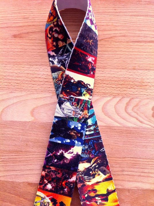

I know this is an old thread, but polyester webbing is very much printable, although it shrinks quite a lot, so you need to preheat it for a good 20 seconds. But it gives great results, an example:
https://scontent-b-lhr.xx.fbcdn.net/hph ... 1050_n.jpg
I only printed one side, but obviously both could be done if you wanted :)
Using Ricoh SG3110DN printer, Sublijet-R inks, and rubbish cheap heat press from Coralgraph!
Bespoke pet accessories, by Leading the Pack
Re: Webbing
very much printable ;)
[ATTACH=CONFIG]2249[/ATTACH]

what temp and time would you recommend, im getting reasonable prints on the belts with 350f and 140 seconds but is there a better temp and time, also paul how did you print the whole belt with no white bg without it leaving gaps?
Re: Webbing
i print it 180C for 70sec.
and to print large you need large press :)
