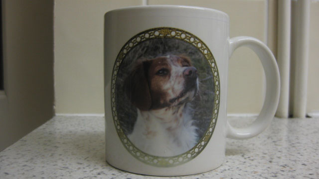

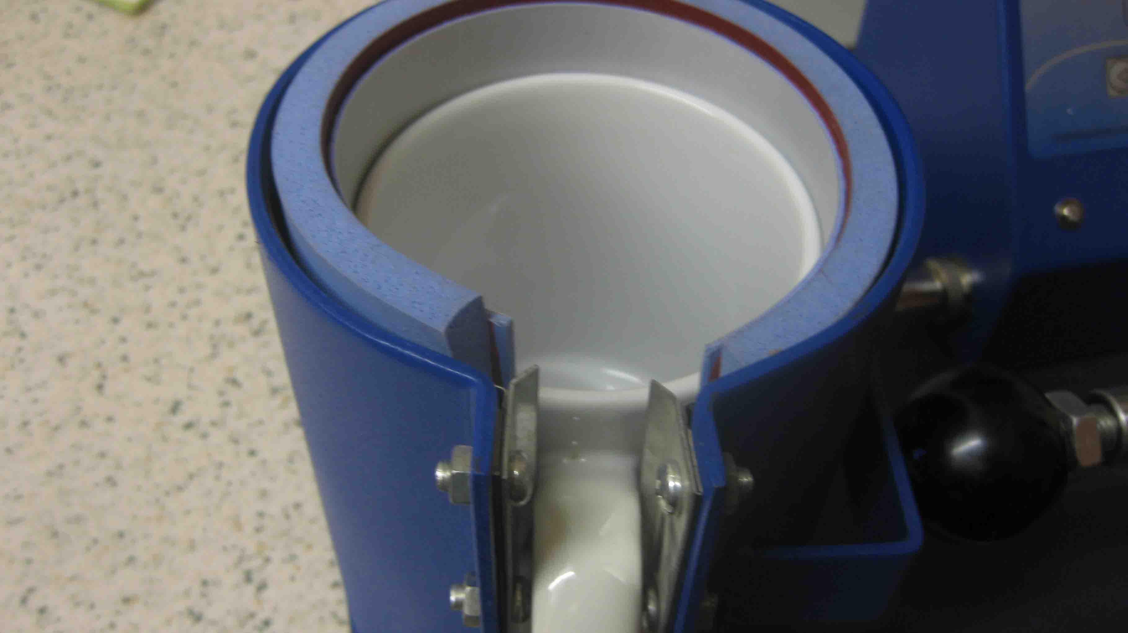

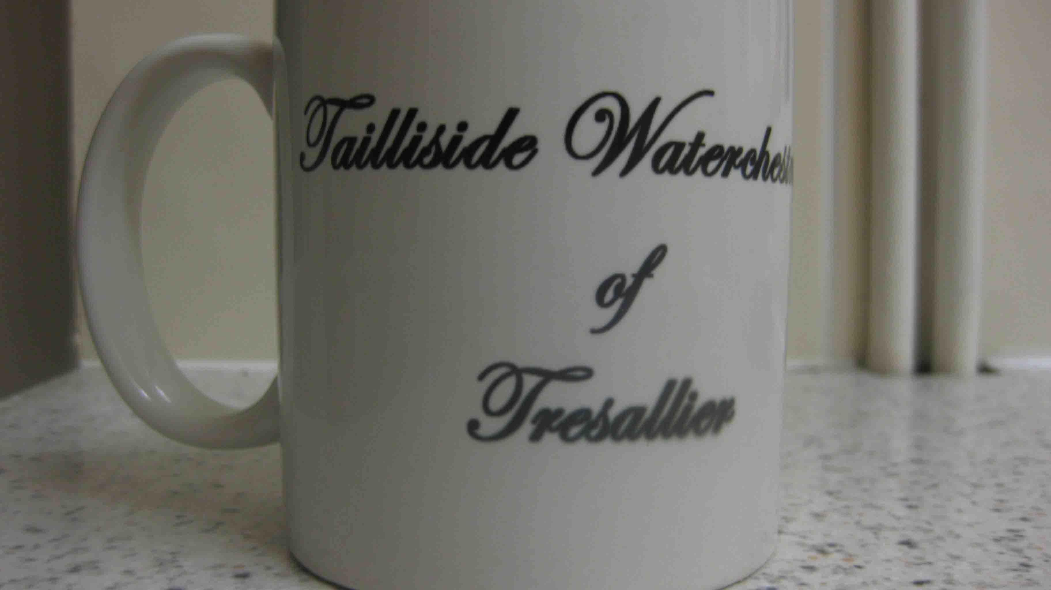

[ATTACH=CONFIG]1417[/ATTACH][ATTACH]1418[/ATTACH][ATTACH]1419[/ATTACH]i have increased the pressure but the mat is not covering all of the mug due to clamping on the handle i have not give it to much incase i put to much pressure on the handle i have printed another mug here are the results and also a picture of mug in press and you can see on left handside a gap at the top can anybody tell me what the black line is above the picture any advice would be great

Re: 1st mug printed
If you are wanting to continue doing mugs of that size, you will need to buy a press that can accommodate the chunkiness of the handle.
Is the black line on the transfer paper before you press to the mug?
Is the black line above the edge of where your transfer paper is, ie the bare mug is touching the press itself and not paper, and may be getting transferred from the press itself?

they are 110z they was on offer so thought i would buy some for testing would it be worth trying to put a sheet of silcon in beetween or am i wasting my time ? i think the black line maybe at the paper edge i think i may have trimmed it short not sure what to do next

It doesn't look like the mug is as snug in the clamp on the left side of the image as it is on the right..

Even if you cut the paper short it wouldnt leave a black line, unless ink was on the paper or press.
What press have you got, is it the right blanket for that size mug? How wide is the handle of the mug?
