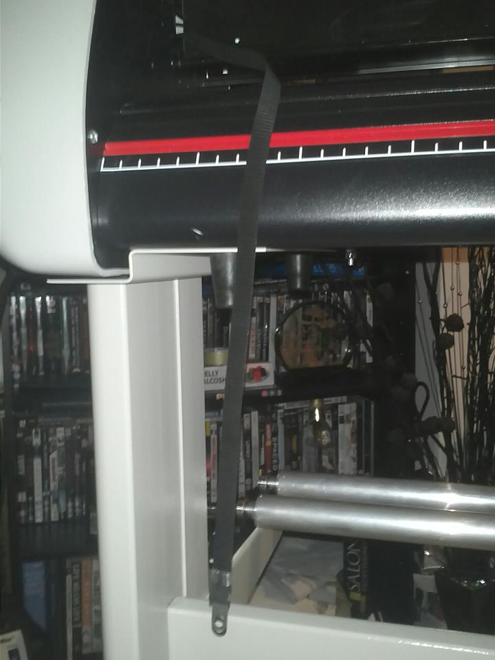

cutter images attached as you can see something is dangling i am wondering if it relates to horizontal movement as when pressing the arrows it only moves front to back

This is your carriege belt! Withou it yo wonbe able to ct! Contact supplier about this a its damaged. You can attempt to join it together but i woul not.

i wouldnt know where to begin trying to do it myself, it was like this when i took it out of the box, im pretty angry right now as it has cost me 230 pound and would cost another 20 pound to return it by post the instructions for the simplest thing are terrible and it took me about 2 hours to put the stand together i do not wish to dismantle it all to return it
Re: got my liyu cutter, questions...
cutter is hold only on 4 screws. so you can unscrew it all and send it back at supplier expenses.

yes its from a company called signcut, there are 4 screws in each leg connecting to cross beam, there is 4 screws connecting each foot there are 2 screw in casters on each side there are 4 screws on each side of the roller bracket and then 4 holding the cutter on the stand and as most of the screws have to be placed inside a deepish hole in order to connect the pieces sometimes the screw drops inside the legs, i dunno it was a hassle but if thats my only option i will have to
no. just take cutter off the stand. and send only cutter back. leave the stand. they should send you fixed cutter/or new next day. so no need to disassemble the stand

It might be hard getting them to accept that you could see nothing wrong with the cutter, and even went so far as trying to get it working, when this belt was hanging down, lets hope they are one of the good companies, like paul says, they should not need the stand back, as it has nothing to do with the cutter at all. just call them, tell them its faulty, also notify your credit card company if thats how you paid for it, or paypal if thats how you paid for it, show them the photo of it (off of the stand - otherwise they might think you caught the belt while lifting it onto the stand which can happen)
