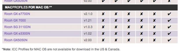

I discovered the profiles are not released for USA and Canada, but thanks to the link you gave me, I got one de Sawgrass Europe, thanks infinitely Martin
[ATTACH=CONFIG]1372[/ATTACH]
vB_ID:1372
vB_ID:1372
Picture 4.jpg (18.65 KiB) Viewed 221 times
