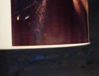

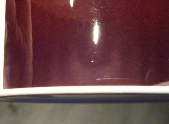

just an update. I have printed some more mugs from another box with same results.. here are the pics.. same area again.
[ATTACH=CONFIG]1327[/ATTACH] [ATTACH=CONFIG]1328[/ATTACH]
First one i printed with top of mug at the top.
Second i turned mug upside down and problem is in same area.. Has to be mugs..

Maybe the mugs taper slightly ?? would that give the same effect ??
Re: Heating element on mugs.
well i would think that would however i have adjusted the pressure up and it does not make a differance.
Paul said in early post to get a silicone sheet to even out the pressure and i said not going down that route...lol
I might try it though as im still on a learning curve myself and feel i need to explore all remedies just so that in future i know how do deal with problems better.
