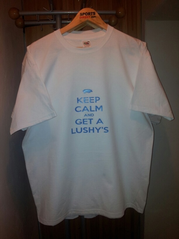

So something like this should be ok ?
lush's is the name of his butchers, no crown just a little piggy.

Dave271069;58506 wrote:So something like this should be ok ?
way to small bud....

Re: Best way to do keep calm tshirts?
Ok, thanks
t-shirt is a xl . I'm gona give him another one free so maybe ill do the next one bigger, but how big.?
i done mine at - word "calm" was 10" max across - the "keep" was 8" so it sits in the middle of the calm word...the other words depends on what you wanna put on there....you want it to be big enough, but when you put your arms down, you should still be able to see the writing ok without the end letters getting obscured with the fabric when your arms are down .Dave271069;58510 wrote:Ok, thanks
hope that helps a bit
note...and thats on a xxl and a xxxl shirt
Every one has there own way of doing these...ask others on here and it will prob be different...
