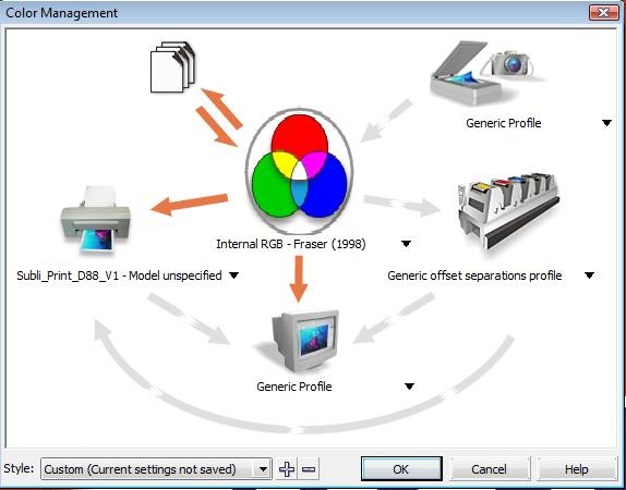

Hi Lewis, The first thing I have to say is the Epson S22 is not a supported printer for doing this kind of work.
You do need to set up your colour management in Corel 12 which is what I use to print all my transfers & you will find this under tools. I've attached an image to show you how I have mine set up. I've also included a link to show you the other settings you need to use for your printer which might help you too. I know everything is for the Epson D88 but, I use an Epson S21 & have found these settings work best for me. http://www.xprestechnical.co.uk/downloa ... nwards.pdf
Just one other thing Paul who is a member of this forum can also make you a custom ICC profile for you. Good luck.

Re: Just getting started and am super frustrated :(
Well done for Ian!
I think you instaled icc but you disnt set corel to us it. Also in your printer profile please e matt paper and photo qualitt. Please swirch icm off. Dont use vivid or other settings as the will mismatch with your icc.

Thanks Paul :wink: Paul, the pdf link I've included does show how to set the printer up for the paper settings etc. I have it on paper here & it's a really useful tool to have as I found out when I switched to my new computer.
