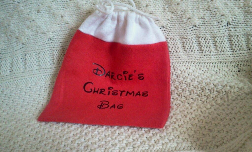

I have just pressed onto low pile fleece.. and even though it's good enough for what I am doing.. I am not 100% sure i'd trust it to do it on actual clothing..
[ATTACH=CONFIG]1203[/ATTACH]

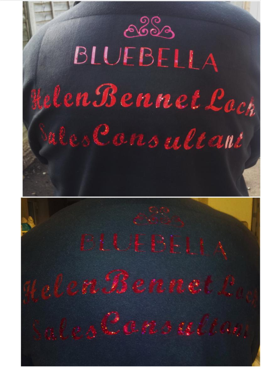

Ok I tried pressing vinyl to fleece and it adhered very well.
Problem is the fleece gets badly squashed.
I pressed a glitter Vinyl at 160 for 15 seconds.
I covered with paper and had a medium pressure.
I have washed the fleece and it looks a little better.
I think i maybe should have done as the poster advised and protected with more fleece for 45 seconds?
I have added the result. The first is a very obvious press mark and the second after a 60deg short wash and quick tumble.
Still there but not as pronounced.
Not great, but it proves you can press Vinyl to fleece.
Tony

I always find flock is better on fleeces as the pile of flock is similar to the fleece. I find that flex sits on the pile too much.TonyM;54863 wrote:Ok I tried pressing vinyl to fleece and it adhered very well.
Tony
Sometimes a stiff brush against the pile helps bring it back up okay.
