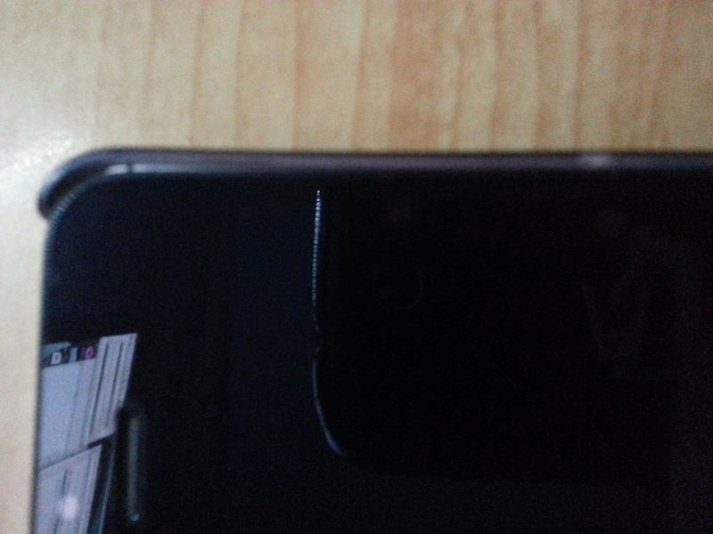

We have a 3D vacuum machine and they are not all they are cracked up to be, you see people selling cases at £19.99 thats because they are costly to produce due to the fault rate due to poor cases or colours dont always sublimation well at all. Also labour costs are more due to them being more fiddler and just a pain in the arse.
[ATTACH=CONFIG]1188[/ATTACH]
In the above example you can see case warping and a spot where it did not get a good vacuum, also the case has a twist to it very disappointed, and before I end this rant the cost of the jigs and machine means we will be lucky to see a return on this machine in the run up to christmas.

Hyraxx;53403 wrote:We have a 3D vacuum machine and they are not all they are cracked up to be, you see people selling cases at £19.99 thats because they are costly to produce due to the fault rate due to poor cases or colours dont always sublimation well at all. Also labour costs are more due to them being more fiddler and just a pain in the arse.
Is this the large vacuum machine or the newer smaller desktop ones that are coming on stream. The desktop ones weigh in around 18kg so quite portable as well.

The large version, picked it as it could do up to 6 cases at a time, the desktop version could only do 4 max so went with the larger for better productivity but have been far from impressed so far.
From the supplier we use they have said that a new style iphone jig is in the works but at around 50/60 quid each, and having to have at least 18 jigs to get a good through put again is costly and puts the machine costs up again.
