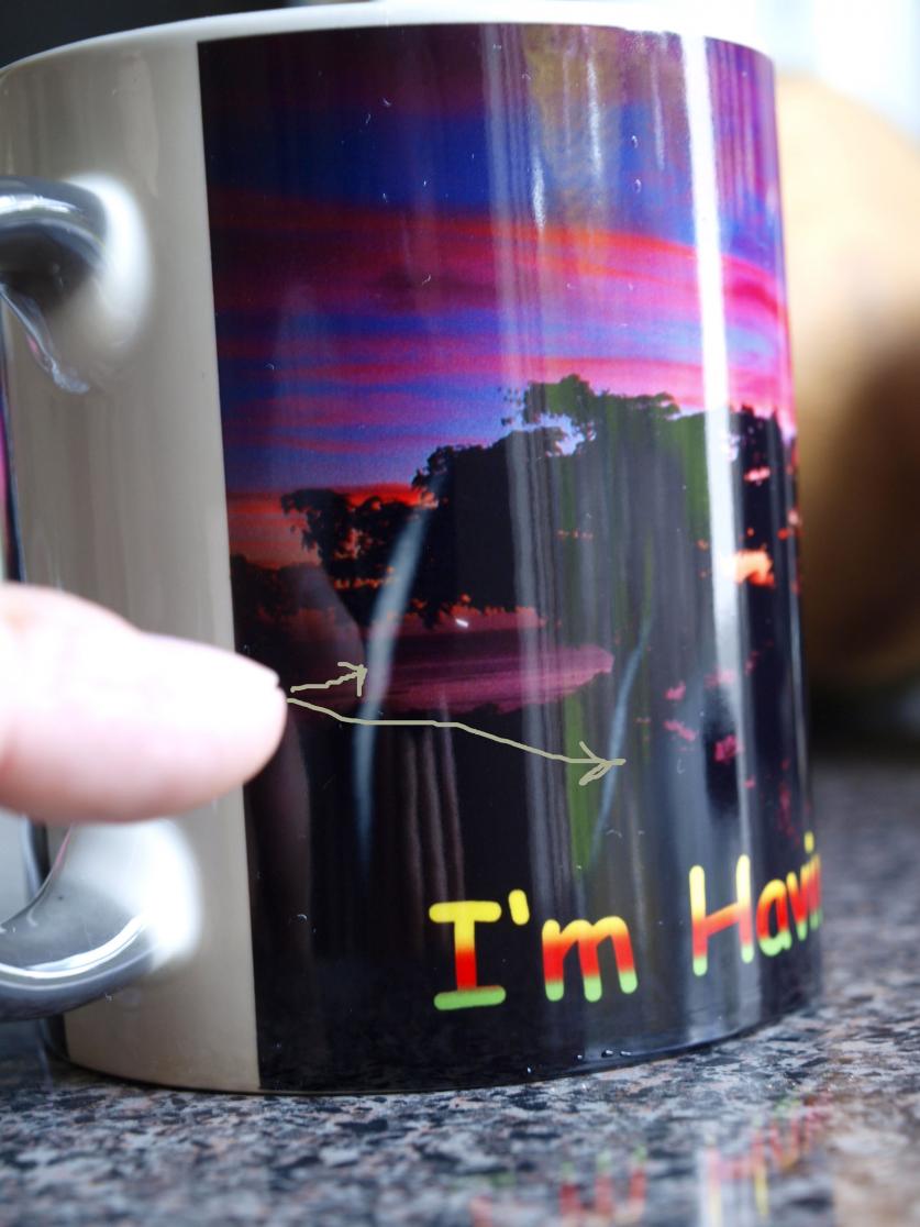

Worthdoingright I have tried putting a "blow out sheet" over the sub paper and tried it without but still the same. Yes I am taping the sub paper down onto the mug.I have put an image of the mark. Ignore the reflections thats just bad photography but I have indicated the offending spot. It seems to happen at either side of the handles.

Do you see a crease in the paper after removing? It does look like the paper has been pinched. If it was the wrap not placing enough pressure I would have thought the mark wouldn't be so defined. How many have you had like that?

Yes Andrew the paper has a crease when I take the wrap off and on the sub paper I can see a corresponding dark mark where the dye hasn't released. I have had too many unfortunately. The image that I have posted is one that we print a lot of for the tourists and I did about 10 to get three good ones. Never had this fault before.Had plenty of others but not this one ;-) I have made sure that the sub paper is tight on the mug before taping it but I still seem to get it. The only other thing that I considered is that the humidity here is high at present and wondered whether this might have a bearing...
