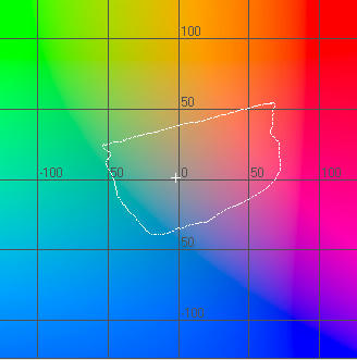

trueWorthDoingRight;51942 wrote:And even fewer even know what colour gamut is lol
this is gamut. all inside is my color gamut. that means all those colors can be produced by my ink/ printer

Hi Paul
I just did a screen shot and print of your colour gamut and the whole square printed. Does this mean the gamut on my machine is better LOL!!!!!!
I use 4 colour Ricoh 7000 and never had a complaint about colours but if I do I would tell them that "a blind man would like to see it and to go away" I wonder why I do not work with the public!!!!
