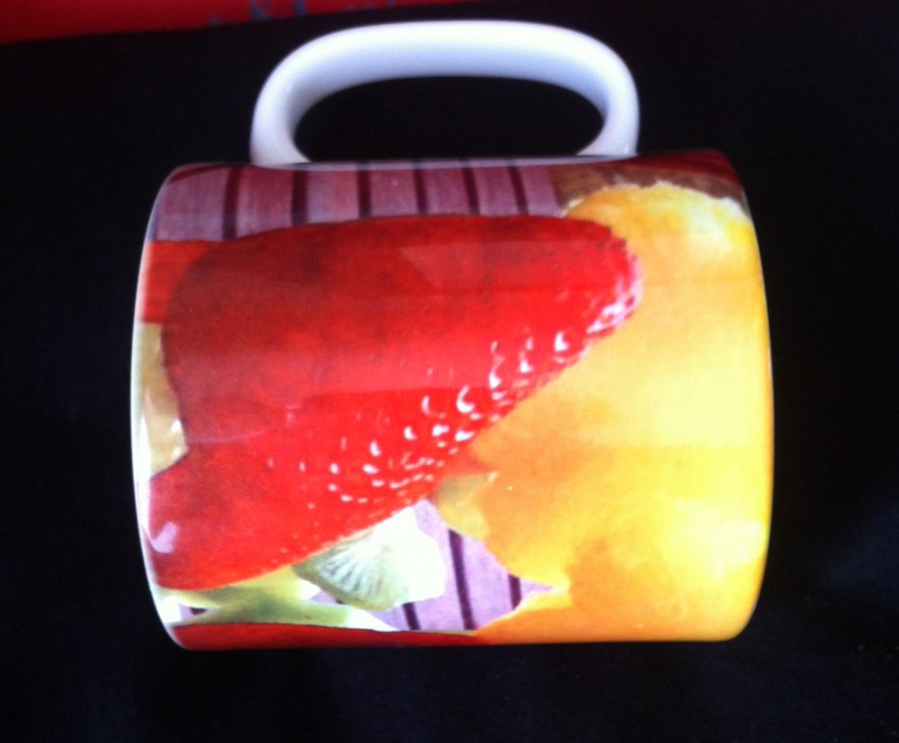

Although will share a pic of my first mug which as you can imagine couldn't believe finally something I've done with sublimation and it wasn't too bad in terms of colour![ATTACH=CONFIG]1127[/ATTACH]
