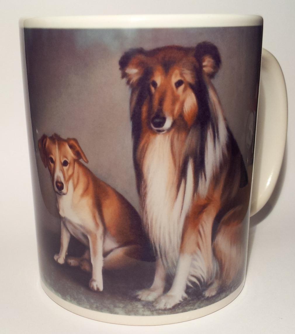

1: Mug Picture of the Dogs:
This is actually a photo of a painting of my mates dear departed dogs. Was pretty impressed for 1st try. I can see it was just not tight enough as the top edges are a bit iffy. 180 deg - 180 secs

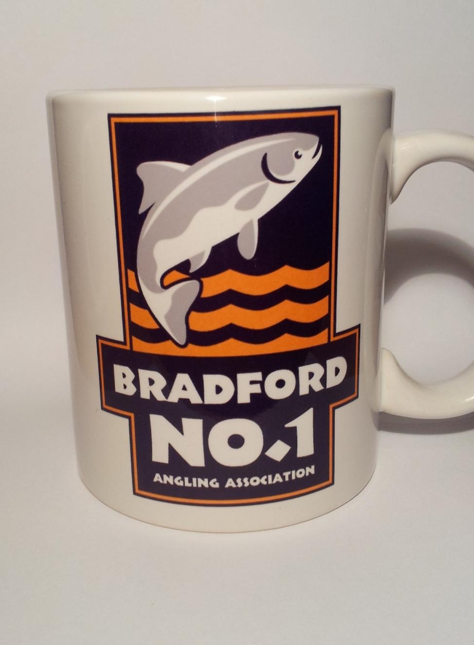

2: Mug Picture - Bradford Angling Association:
This company contacted me about Embroidery for T-shirts for members of the club. So what better way to promote even more items to sell to the club. Very happy with the results, Just tightened the mug press up a little bit for this one & it seems nice & clear 180 deg - 180 secs

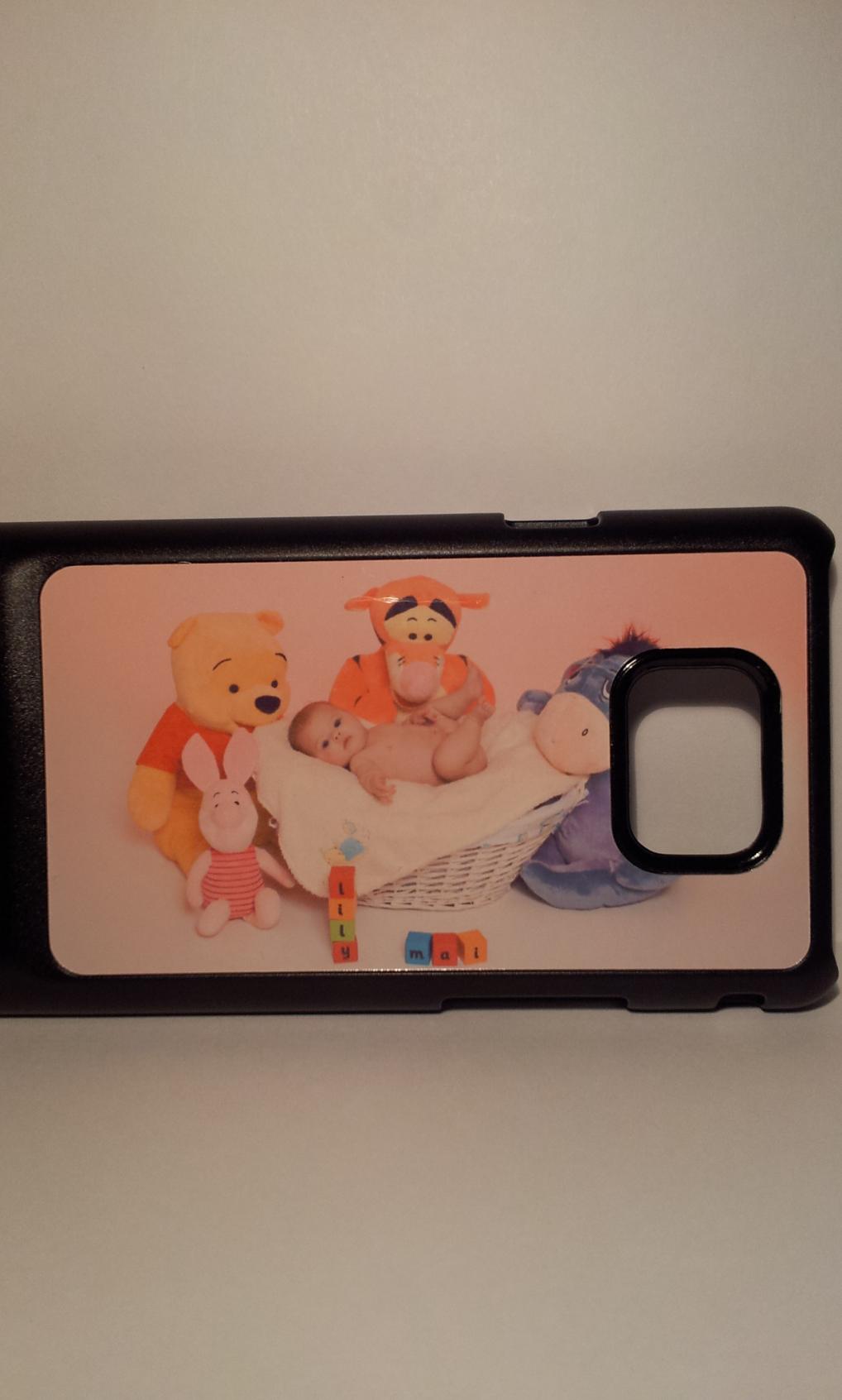

3: Galaxy S2 Case:
My beautiful Grandaughter Lily-Mai. Quite happy, not 100% as don't think the pink seems as deep as it could. 180 deg - 50 Secs

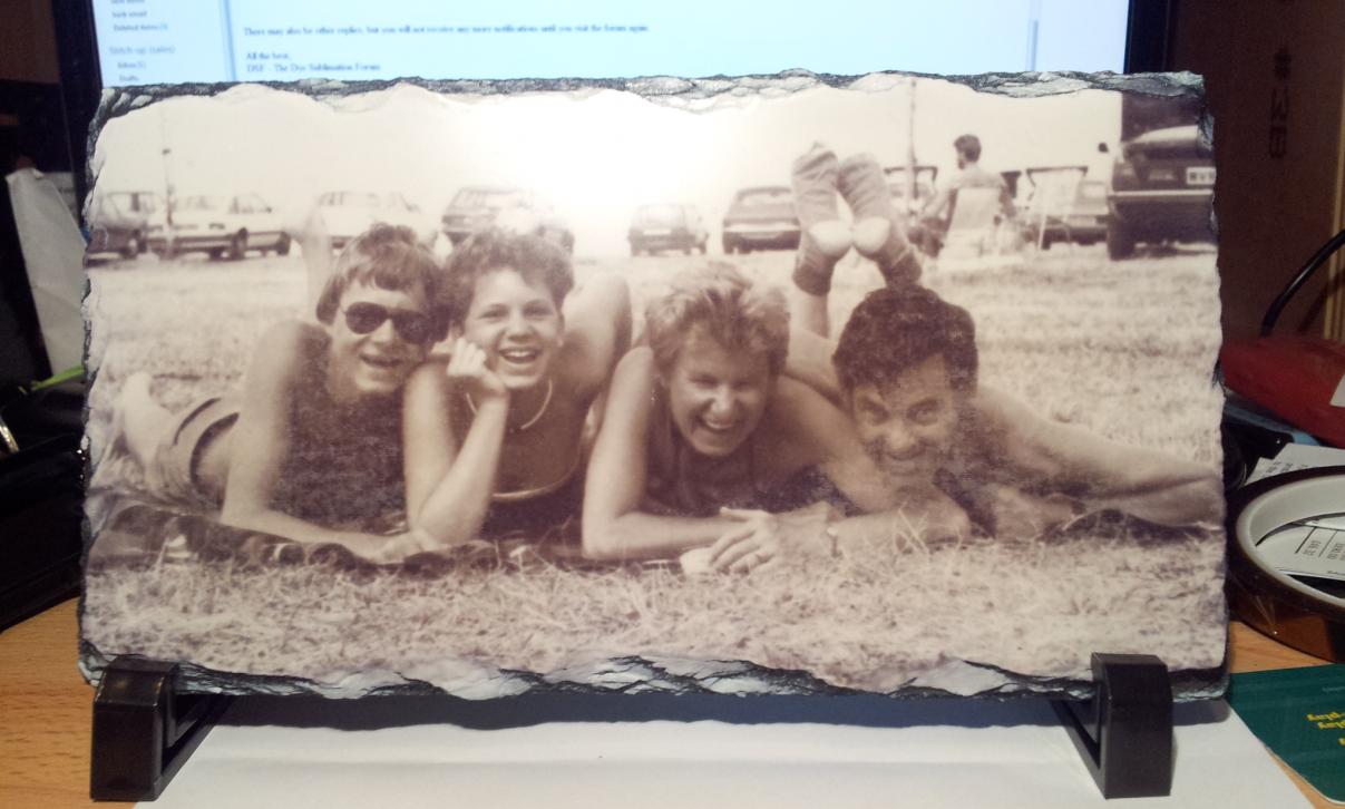

4: Coralgraph Rock Slate:
This was originally a colour photo which the guy sent to me as black & white. This was the 2nd one i tried as 1st one looked even worse. Cannot work out what was wrong. too much heat, too much pressure. 1st one just did'nt seem to sublimate correctly & i put it down to not having it central in the press (Swing away) & not long enough.
So i put the heat to 205 deg for 480 secs. (Think i've now baked it for too long but i'm sure you guy's n gals will tell me where i'm going wrong)
Overall well impressed with the quality. Plenty of tweaking to do. & this is where i ask you guys for your help !
3: Galaxy S2 Case:

well done m8.....no longer a sub virgin lol...
the bradford one looks really clean and sharp......

for the slate i use 205 for 440 seconds - you using a rubber pad on top?

Nope, was just this minute on the BMS site looking at the slates & noticed it said use rubber mat. That looks like one thing i've missed !bassqee;45635 wrote:for the slate i use 205 for 440 seconds - you using a rubber pad on top?
Thanks bassqee

love the angling mug, and thats the right way to go about it, if i do a large t shirt run, i always put a mug in the box with them, printed up, i have had 7 mug orders now, one for over 100 mugs, just by popping a sample mug in the box with the shirts, and the baby photo is lovely as well

The pad also helps with the edges too.
Re: I too have lost my virginity ! (But it took longer than 2 minutes ! )
It really buggered me up as i bought a pad amongst other stuff as i read it needed it... just never thought about it when i actually came to pressing !
