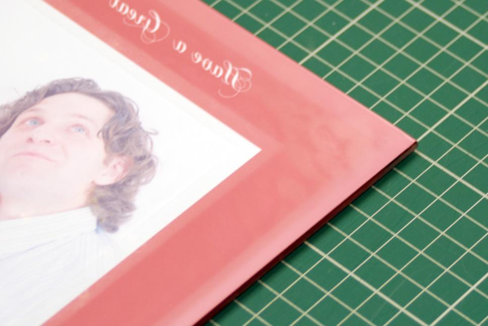

The thing is - I have had loads of breakages when I try to press them which obviously means too much pressure. So, I lower the pressure but have to up the timings.
I've been in communication with Martin at BMS and I think we've ruled out the fact of these being a faulty product -I just need to get it right!

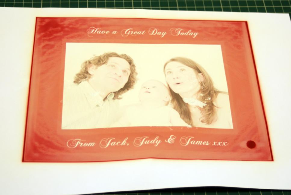

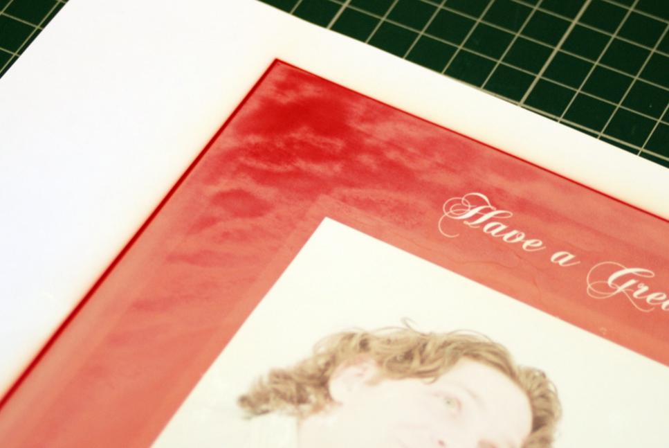

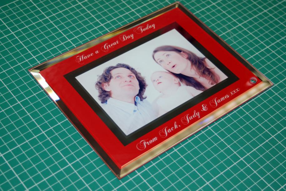

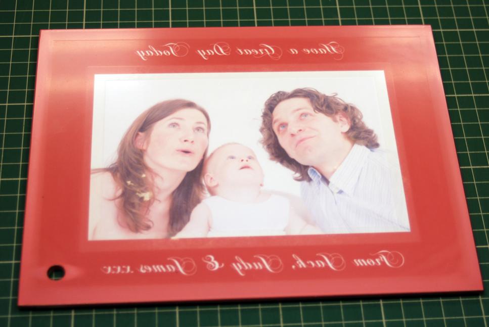

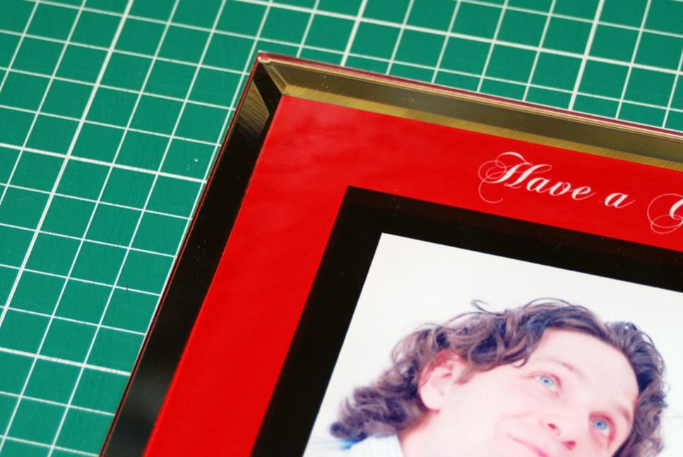

My hope here is that others may be using these and I could compare notes, a few images are below of the 'last' one I tried to press. It seemed to go well but 1 area of the image didn't transfer very well (top left as shown).
[ATTACH=CONFIG]976[/ATTACH] [ATTACH=CONFIG]977[/ATTACH] [ATTACH=CONFIG]978[/ATTACH] [ATTACH=CONFIG]979[/ATTACH] [ATTACH=CONFIG]980[/ATTACH] [ATTACH=CONFIG]981[/ATTACH]
The BMS site says to use the following to sublimate this sustrate:
Pressing temp 190 degrees for 90 seconds, medium pressure.
This was the last frame I had and to get a half decent image (as above) I used the following:
Press 1: 195 degrees for 75 seconds
Press 2 (after rotating substrate): 200 degrees for 75 seconds
Press 3 (after rotating substrate): 200 degrees for 75 seconds
(225 secs in total)
Is anyone pressing these with success? If so, could you please compare notes with me :)

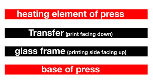

I press them like this:
[ATTACH=CONFIG]985[/ATTACH]

I also press quite a bit of metal and glass (chopping boards etc) and have always pressed this in the opposite way to the above (transfer face up on base plate with substrate facing down onto it and the heating element going down on the 'back' of the substrate - with the heat going through the item to the transfer).
This was the way that I pressed the first two - to be honest, the first may have had a little too much pressure and crack (not toughened glass like the chopping boards). So less pressure and ................. crack!
So I flipped over and tried the opposite (and wrong in my eyes) way - this was the best image transfer I could get.
Reference doing glass and metal the opposite way - not sure why I do this, I think I saw a video or read it somewhere as the heat transfers through the item to get the best transfer?
