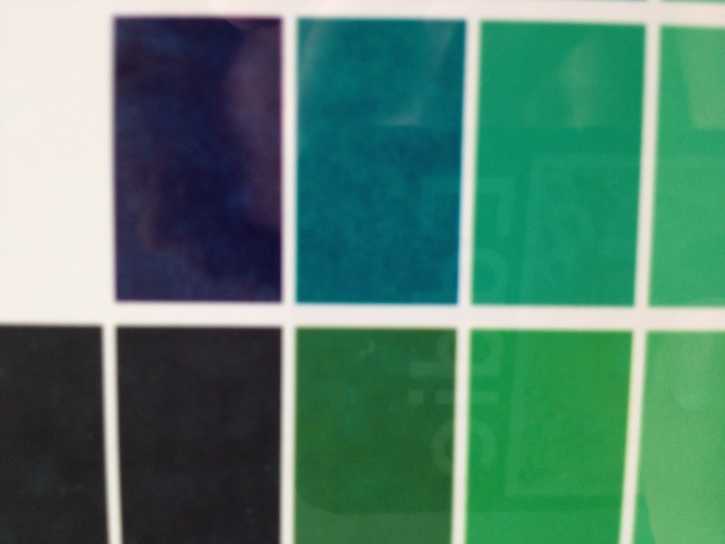

Just double checked everything and this is the kind of effect i am getting:
[ATTACH=CONFIG]917[/ATTACH]
Pressure is fine and temp is fine (the above pic is done using aluminium sheet from transferpress at 190 and 50secs) never had a problem like this before, my press is a from themagictouch and is the 38x38 swingaway.

Hyraxx;43926 wrote:Just double checked everything and this is the kind of effect i am getting:
What specifically is the problem? All I can make out from this is greens going to a darker colour. What should this look like?

Post by Hyraxx »
Well the colours should be solid blocks but ifyou look closely they are not they are blotchy, for example top left blue block has patches of green/grey and looks all blothcy.

Post by RogerC »
looks like uneven heat application to me........though being new to this I could be way off the mark.
