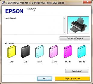

Well.. after spending £160 for this printer and not being able to get it to work and the forum member I bought it from not wanting to take it back I have no choice but to try and sell this now as spares or repair to try and recoup some of my lost money!I have just put in brand new ink cartridges (see pic). The problem is whenever I send a print to the printer it gets anywhere from about 25% to 75% through the print job and then halts. So far out of about 20 test prints it's only managed to print 1 correctly.I am open to offers![ATTACH=CONFIG]798[/ATTACH]Regards, Philip
