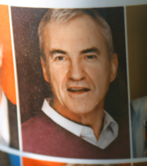

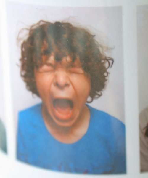

I've attached photos:
1) 210s at 170 C - white bits appearing in solid colour not very sharp image
2) 190s at 170 C but also on mugs at 150s and shorter - faded lines across parts of image
Thank you in advance for any input, would love to get my pressing right.

Doesn't look good at all - are you using powerdriver and printing on right side of paper.
I've never used signal paper so don't know if its any good - where are mug from.

Thank you very much for your reply.
Mugs are from BMS too - European Mug.
I don't use powerdriver at the moment, I colour correct in Photoshop.
I don't think it is to do with the printer at this stage because I was able to produce two mugs that I was reasonably happy with colour-wise and sharpness-wise. (I'm not sure what standard they should be at as I haven't really seen a sublimated mug pressed in another press. The ones I ordered from Jessops in the past didn't look that good to be honest). What worries me is that I wasn't able to reproduce that result on another lot of mugs the next day under the same settings.
The pictures are a bit blurred as a photograph because they are close ups of a particular part of the mug, they don't stretch over the full mug.
What concerns me are the faded lines across the second picture, most visible in the boy's hair, because that was on most of the mugs I pressed, sometimes more visible like here, sometimes almost invisible but still there because I can see it on what's left of the template.
Also, what happens to the images when you leave them in too long - is there any general rule what happens?
Thank you for your help.

Re: New to mug sublimation - advice needed
I can't see the reason why you don't want to use powerdriver - its free, and this is what makes the printer use the right mix, or profile, for the ink.
Setting up in PS - every photo would be different and therefore your results wouldn't be the same.
If you leave sublijet-R gel inks cooking too long, the blacks go off or browny - no need to go over 180 seconds/180 temp - BMS recommend a lot less.
