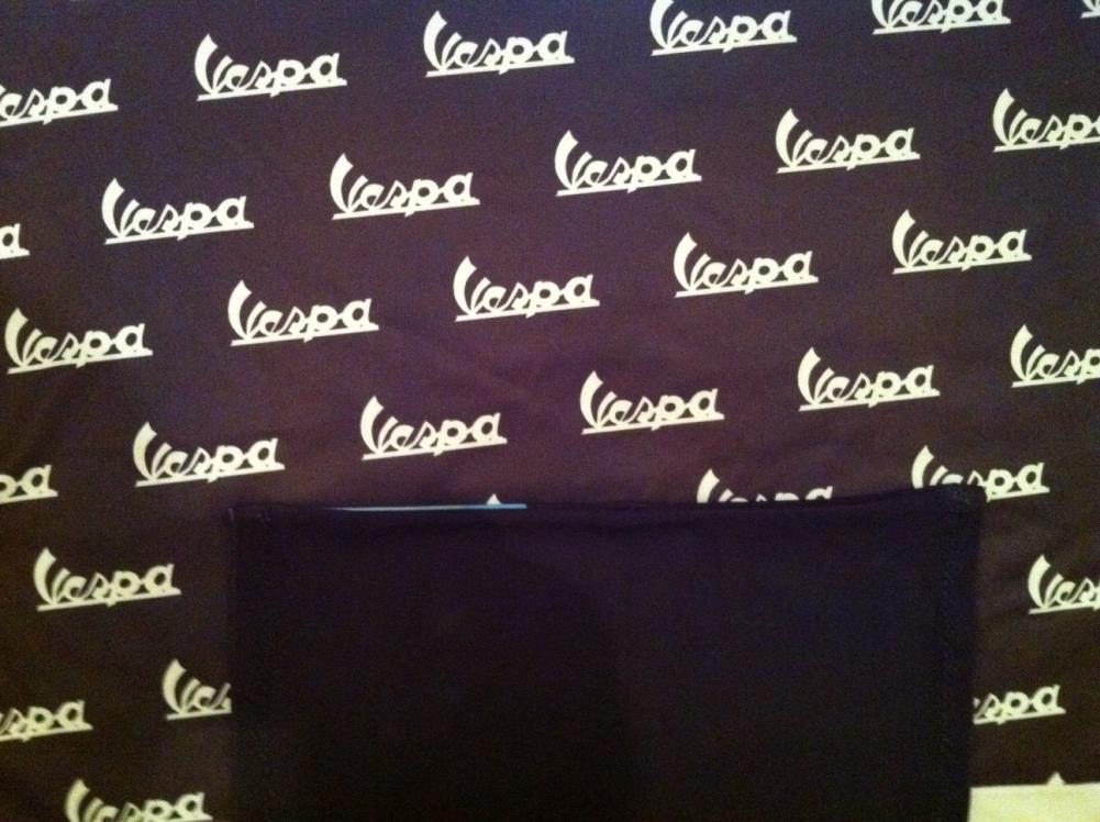

It is often a case of too much heat with a brownish tint but there are other reasons. What time and temp as well as which product are you printing? Is it just the paper that has changed since this has been happening?
Blacks are often hard to get right as you can easily get greenish/red/brown tints if the profile isn't spot on. We always hgad greenish tint on 1290's years ago with powerdriver.
A photo of the problem print would be good.

Here is a photo. the black at the bottom is the colour I should be getting or there abouts, the top is what am getting now
[ATTACH=CONFIG]561[/ATTACH]
I cant make the picture any bigger
