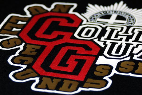

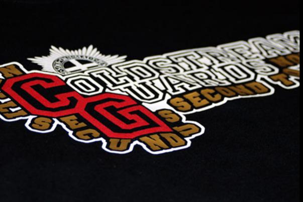

I've used flock and flex on a few designs Paul but I've always done my designs so the flock goes onto the material and not onto other parts of flex - don't know why but if I can I tend to avoid multi-layering if possible so it's not as thick (although I have done it in the past)
An example of avoiding the multi-layering is below:
[ATTACH=CONFIG]509[/ATTACH]
[ATTACH=CONFIG]510[/ATTACH]

thanks Adam!
great designe btw!
great designe btw!
