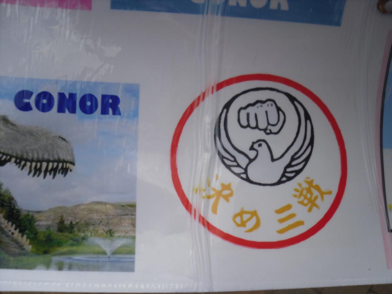

I thought i'd try and print stickers..but they turned out really c**p. The heat started to lift the sticker sheet this seemed to be worse where it was rolled, although the whole lot were rubbish, do i press for 10 sec or so before (like when you get moisture out of fabric)..do i cut into smaller pieces but then what happens if you want an A4 sized sticker....grrr..suggestions, hints & tips very much appreiciated.

I used temperatures as on the BMS shop thats where i purchased from..so there was no other hints/tips only the pressing guide 190/50sec. med pressure, white vinyl sheet.

i used the bms stickers the ones i printed were about 6x3" stickers i found that if i pressed them as 1 a3 sheet i had same result as you but if i cut them to size first then they seemed to work ok

There's no protective film on these. We've always cut the sheet to the size of the image in the past, possibly laid multiple pieces in the press with a sheet of silicon paper on the bottom and top.
