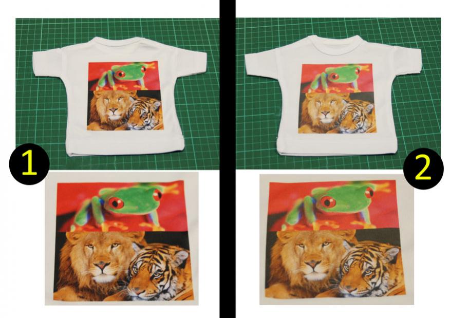

after printing a 100% polyester vest yesterday I thought I would try something that may be benificial to new members.
As I don't do much sublimation on 100% polyester garments I'm pretty much a virgin in this area (I use chromablast on white t-shirts, and vinyl and transfers on the rest). Due to this, I only usually sublimate the generic items (mugs, jigsaws, placemats, coasters etc) so I have really only used one type of paper - Trupix - which produces excellent results on what I make (if it's not broke, why fix it).
So, yesterday I pressed a 100% polyester vest using Trupix paper and Artainium ink and was impressed with the result (a potential order pending). It was mentioned that certain paper should be used for clothing as they are 'high release' paper and let more ink get to the surface of the garment, good for garments but not for hard surfaces.
Well, as I'm curious (and extremely busy but it was bugging me) I decided to test the papers.
I didn't want to waste a vest so I used a mini t-shirt which is also 100% polyester. I pressed bot for the same time and the same temperature - I know there may be tweaking but I was just curious of the results.
I have an image below of the results. The left side (1) of the t-shirt was pressed with Trupix paper and the right (2) was pressed with TexPrint XP HR (high release) paper.
[ATTACH=CONFIG]394[/ATTACH]
I didn't really expect a difference but I was amazed at the difference using a high release paper. What I thought was good (2) now looks quite faded and bland compared to the the other print (1).
My question is now, apart from garments - is there anything else that should be pressed with HR paper?
Adam
NOTE: The images are as is - not photoshoped not with no flash.

A question I have just thought of, do things like mousemats, flexible coasters, sunscreens, bibs, tea towels, mobile phone covers etc which are all 'material' based required HR paper for best results??

Paul;25535 wrote:whoever mentioned that hr paper is good for fabrrics but not for hard surfaces is WRONG.
thanks for the reply Paul .................. yeah it does make sense to use one type of paper if it works on everything - but I'm sure I read it somewhere, I spent about 6 weeks just reading and watching videos before I went into this stuff so I'll find what I refer to :-)

thats really handy to know Adam cos i am sure somewhere it said you should use textprint on T's etc and trupix on hard stuff
although i only have tru so use it on everything and will admit it does come out a bit more faded on clothing
where as hard surfaces mugs, coasters etc it's really really vibrant and clear

My own experimentation has proven to me that while you can use one paper for all things, it's best to use the right paper for the right thing if you want the best results.
For me, that's TexPrint HR for fabric items (t-shirts, mousemats, etc) and a low release paper like TruPix or Xpres (from BMS) for hard items (ceramics, coasters, etc).
There are always exceptions to the rule. For example, I might use TexPrint on colour-change mugs to lower the cooking temperature (TruPix seems to make the mug go yellow). TexPrint also works better on glass items (because TruPix sticks to it). But if I use TexPrint on regular mugs at the regular cooking temperature, the result is less defined and softer than if I use TruPix/Xpres.
Likewise, you can't generalise. While you can "get away with" TexPrint on hard items, I once tried an economy high release budget paper from BMS (that they don't sell anymore, fortunately) and it was utterly *terrible* for hard items.
At the end of the day, if you regularly do both types of items and you want the best results you need the best paper. But if 95% of your work is one type and you only occasionally do the other type, then there's little point in buying both. Just work out what's best and go with that.
