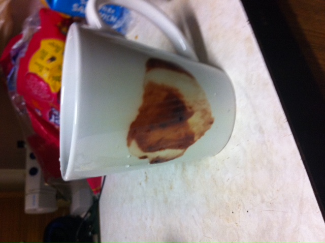

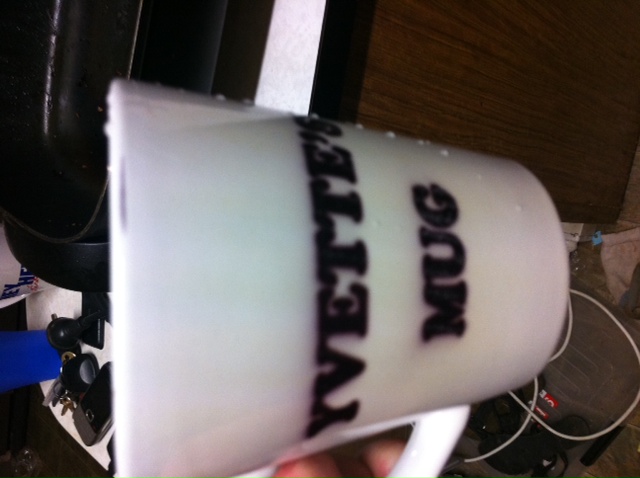

Hi, I am totally new to mug sub. I bought a 5 in 1 machine, after a week of getting things right I can actually print something now. It been 1 step forward athen 2 steps back.
printed my first mug at 190c and 200 seconds ( as recomended). The paper came out burnt and the image and text came out yellow/brown and the text all yucky. popped it on the room temp water and it went crack but can't see a crack.
So then did a new mug at 180c 180 seconds, same thing come out burnt looking but I didn't put it in water but still came out sumdged/bleeding.
I didn't put a teflon paper around it as the instruction video man didn't.
Also the latte mug keeps slipping out of its holder when it warms up, so then I have to try and hold it in while it cooks.
So any suggestions would be great.

@Chucky can you tell us a couple of things...
1. What mug press are you using?
2. what inks are you using?
This will help us advise you... to me it looks like you are cooking for too long...

id say either too long or too hot or a combination of both also not enough pressure on the press its a bit oif trial n error you need before you crack it.(no pun intended)

are you taping the paper on well enough and tight enough ??

its a max armour 5 in 1, so it has an attachment for the mug.
I am using Visi-Sub Sublimation Ink
I am scared to make it tighter in case it smashes

dumb question but is the sub paper supposed to burn

I think I have solved some problems, I set the machine to 150c and for 3 minutes, nuch better finsh. no burning.
But now I have another problem, I did a colour check, the colours that come out ontonthe mug are nothing like the original. They seem to be darker.
Then I did one of my daughter riding her horse, her horse is very dark and can't see much definition, then this mug had some fading as it was close to the top and the stupid mug slipped out.

Where did you get your latte mugs from?
I've found on colour-change mugs that I have to reduce the temperature a lot just to avoid it turning yellow. Regular white dishwasher-safe mugs with RN or Orca coatings can take a much higher temperature and don't react in this way.
Maybe the yellowing is due to the mug coating, rather than anything else you're doing? If so, that might also cause your lack of definition on the print. (I don't do latte mugs, so I can't really help beyond this.)
Re: Burning and smudging/bleeding and latte mugs
I noticed that if the paper wasn't burnt the mug didn't go yellow, the mugs I got are from picture perfect products, not sure of the coating.
I don't think I will buy latte mugs again even though I love them.
