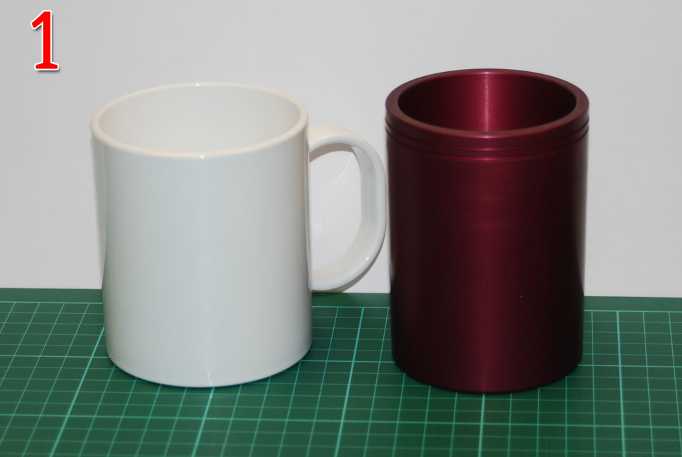

Firstly after I had found my mugs (apologies to BMS, they were that light I never knew they were in the box) I realised what people meant by the weight. Although they feel very light, there is a quality feel about them. They are the same size as an 11oz (European mug) and the puck fits inside very, very snuggly.
[ATTACH=CONFIG]315[/ATTACH] [ATTACH=CONFIG]317[/ATTACH] [ATTACH=CONFIG]316[/ATTACH]

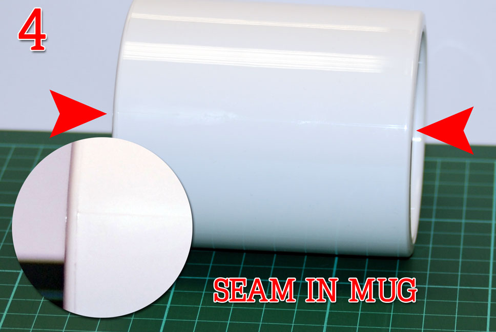

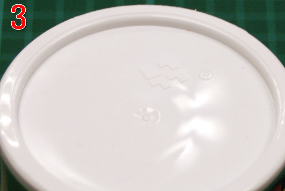

A closer examination of the mugs reveal that they have a very glossy outer and the sides seemed very straight (always a good starting point). I noticed the symbol on the bottom of the mug that I believe is the SunFly symbol (if I'm not mistaken?) (IMAGE 3) so I was pleased that I was finally trying something that I had looked at many months ago! My first thoughts of a plastic mug was, well - just that really. What I mean is that I thought the mug would be one piece of plastic that had come out of a mould or something. As I looked at the mug I noticed a seam in the middle that looks like two haves have been moulded to the outside of a mug base to create the smoothed surface area ........................ I wasn't sure if this would affect the pressing or not? (SEE IMAGE 4)
[ATTACH=CONFIG]318[/ATTACH]

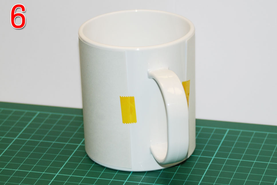

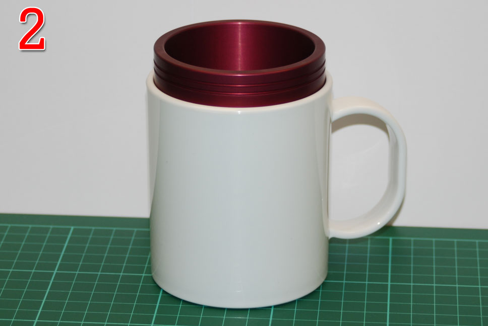

Onto pressing and as there were quite a few posts regarding times and temps I thought I needed a starting point so I took this from Martin (at BMS) who had given the following times/temps - 125 degrees idle temp, 170 degrees operating temp, 90 seconds cooking time. Although there was no pressure guide I presumed that this would be medium?
[ATTACH=CONFIG]319[/ATTACH] [ATTACH=CONFIG]320[/ATTACH]

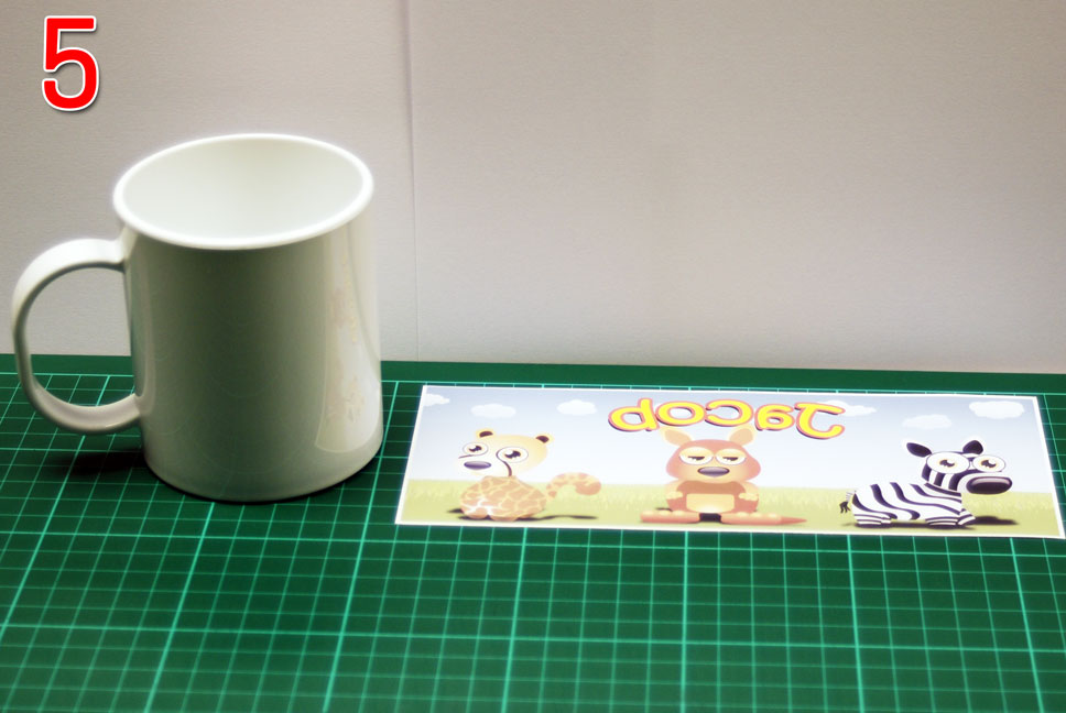

I created some colourful artwork so as I will predominantly be using these for kids mugs. The artwork I created had a small white border at the top and bottom of the mug (I would do a full top to bottom print later).
I placed the puck in the mug, then in the press and waited patiently. I don't know why but I had this horrible feeling that everything would melt in front of my eyes (just like the wicked witch when Dot threw some H2O on her) so the finish beep couldn't come quick enough!
I opened the press, took the puck out of the mug (yes - use gloves as it's hot!) and then ripped the paper off the mug. Usually I do this with bare fingers so I have grown quite accustomed to singing my finger tips ............... but the mug didn't seem that hot - and there was no "shushhhhhhhhh" and "hissssssssss" as the mug hits the (room temp) water (yes - I dunk!).
What I did (briefly) notice was the vibrant colour and what I thought was an excellent transfer of image to mug.
After a few seconds I took the mug out of the water, gave it a dry and a closer examination. The colours were magnificent and the transfer (ink to gas, to mug) had worked spot on. The join (between the two halves that I mentioned earlier) could not be seen at all.
BUT, I did notice that there was a little bit of plastic that had melted on the base of the mug and it looked like the mug press was a little too tight (sometimes you notice the pattern from the blanket on the mug and know it's too tight), but apart from that I was really, really pleased with the first attempt.
SO - SECOND ATTEMPT, and taking all above into account I decided to losen off the pressure a little and reduce the temp down to 160 (or it may have been 165, I will confirm tomorrow) and take the time right down to 60 seconds (30 seconds less).

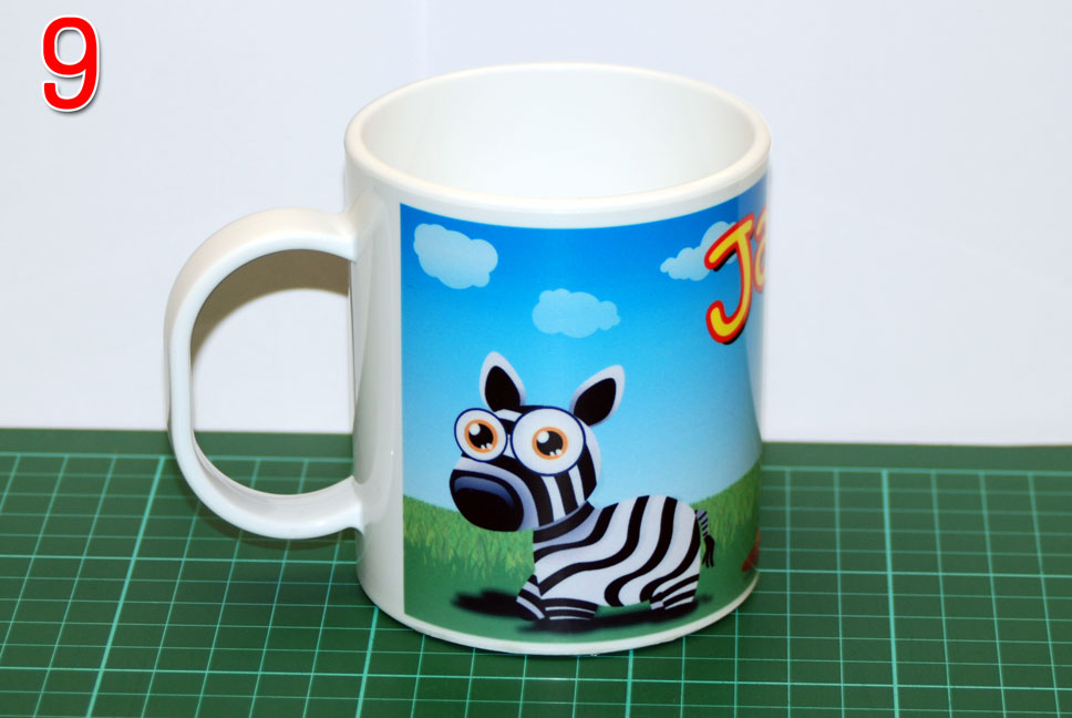

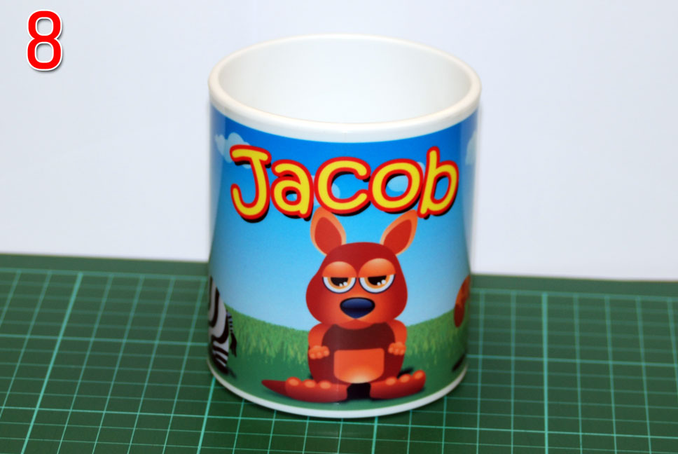

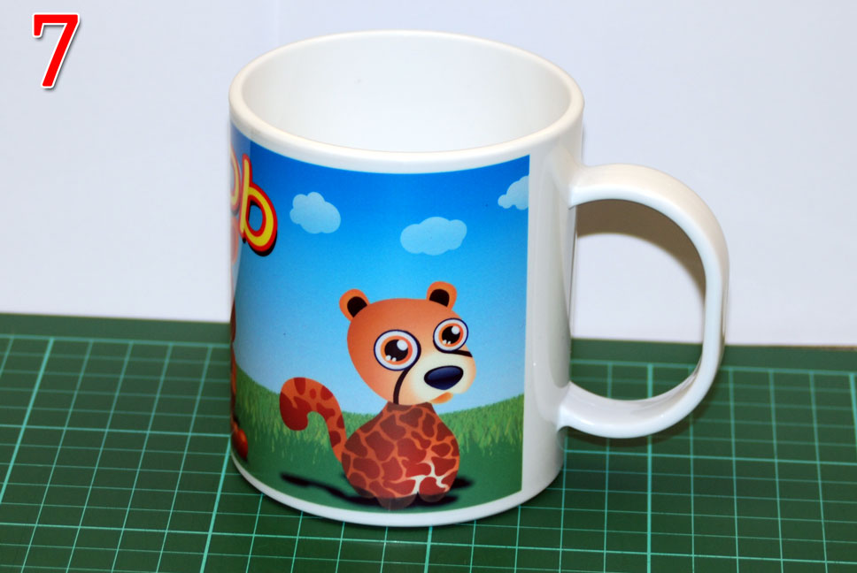

THIS MUG WAS PERFECT IN EVERY WAY. There was no sign of melting, no signs of fadeness - all was fabulous!
[ATTACH=CONFIG]321[/ATTACH] [ATTACH=CONFIG]323[/ATTACH] [ATTACH=CONFIG]322[/ATTACH]

I've uploaded a pic of my first polymer mug. I didn't try full top-to-bottom on this one, but I reckon (looking at all the other photos in this post) that it's possible. Hope this is useful?
