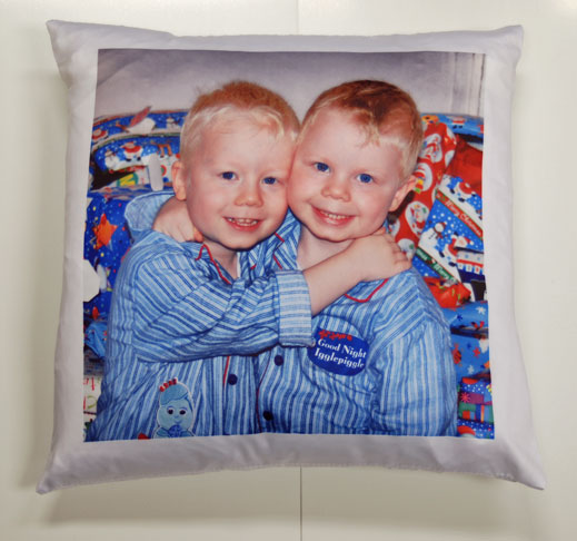

I had to try this after I locked up the shop and it worked very, very well (2 bits of cardboard plus an old t-shirt wrapped around the cardboard making sure that the finished 'pad' is level and flat.
I think the finished product is very nice (the print measures 12.5 inches by 12.5 inches).

very nice adam! but is there any issue with the color on the hair? or is it only picture???
Re: Cushion Covers ............ anyone done them? Ideas please.
No Paul, the picture is fine and the print is great.
I have fluorescent lighting in the shop and it affects me taking pictures of stuff every now and then.
I did try to alter the colours in photoshop once I'd took it but it was making it worse and to be honest I couldn't be bothered messing around with the image (if it was a demo image I would have). Not that I don't care about you all ................. I just wanted to get an image up and to thank fredster for coming back to me so quickly.
